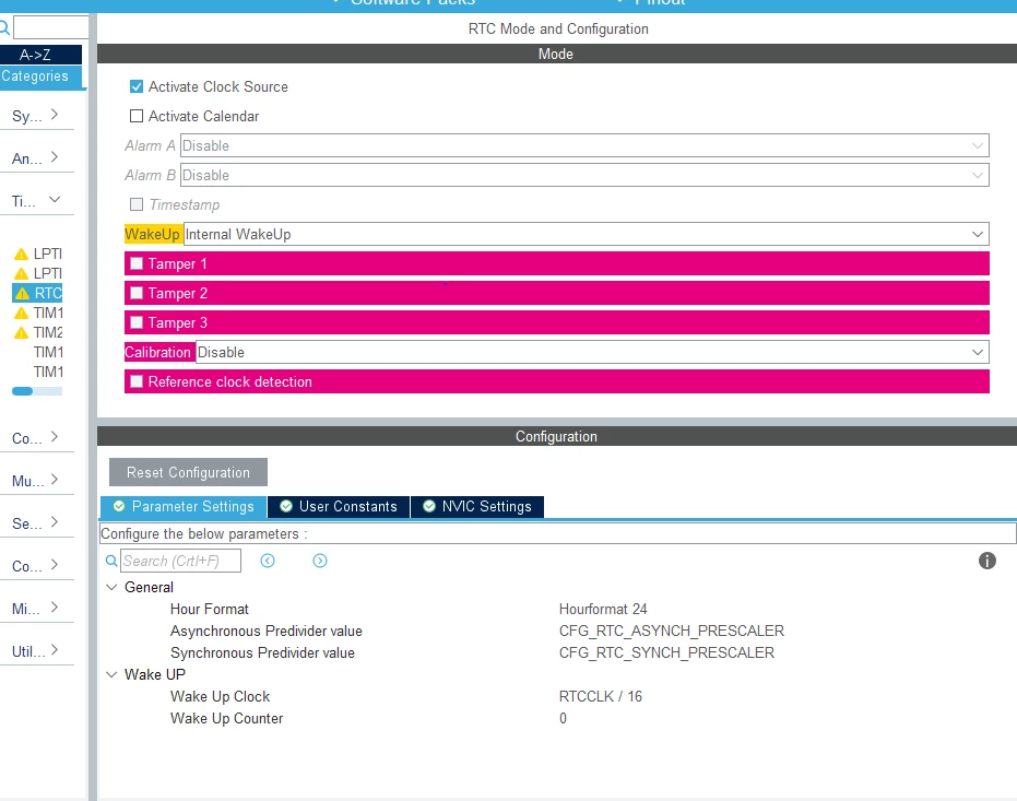

I am building ble application on stm32wb and below is the RTC configuration via cubemx.
0693W00000QLUAHQA5.pngI am trying to implement a scan timeout using the timeserver. Basically, I start a scan procedure and continue scanning until the time-out callback is invoked which terminates the scan procedure. However, for some reason, the timeout callback is never invoked. Below is my API usage.

I'd expect the "scan_timeout_cb" to be invoked immediately but that doesn't happen. Could someone please advise me on what I may be doing wrong?

Alright, I figured out why the callback wasn't being invoked. The HW_TS_RTC_Int_AppNot needs to be user-defined that invokes the registered callbacks when expired. @Piranha​, I am still wondering what you found so absurd regarding my API usage and curious about my invention? Never mind:D
