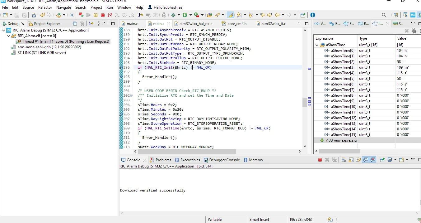

I tried the RTC_Alarm example folder, at first it worked out well and I was able to view the output.
But when I ran for the 2nd time without any changes in the code the execution stopped at
 HAL_RTC_Init ->> (if (HAL_RTC_Init (& RtcHandle)! = HAL_OK)).  And it didn't get through the if loop also.
And strangely when I upload some other code and reset the board (STM32WL55 Nucleo board) and again when I upload the RTC_Alarm code it works fine and again when I upload the same code the 2nd time the code is freezing.
What should I do and where I am going wrong here..

I've tested personally (with different boards) but I can't find any issue. Could you send some data about the issue ( screenshots,...).

 (if (HAL_RTC_Init (& RtcHandle)! = HAL_OK)). it freezes here and the aShowTime values are just at "hh:ms:ss"
I just added BSP_Led_On(LED3) to the RTC Callback Alarm function. that's it even if remove that extra line the same happens.

For RTC use cases, this behavior is normal when debbuging since RTC clock configurations are modified what could generate different issues on the RTC.
