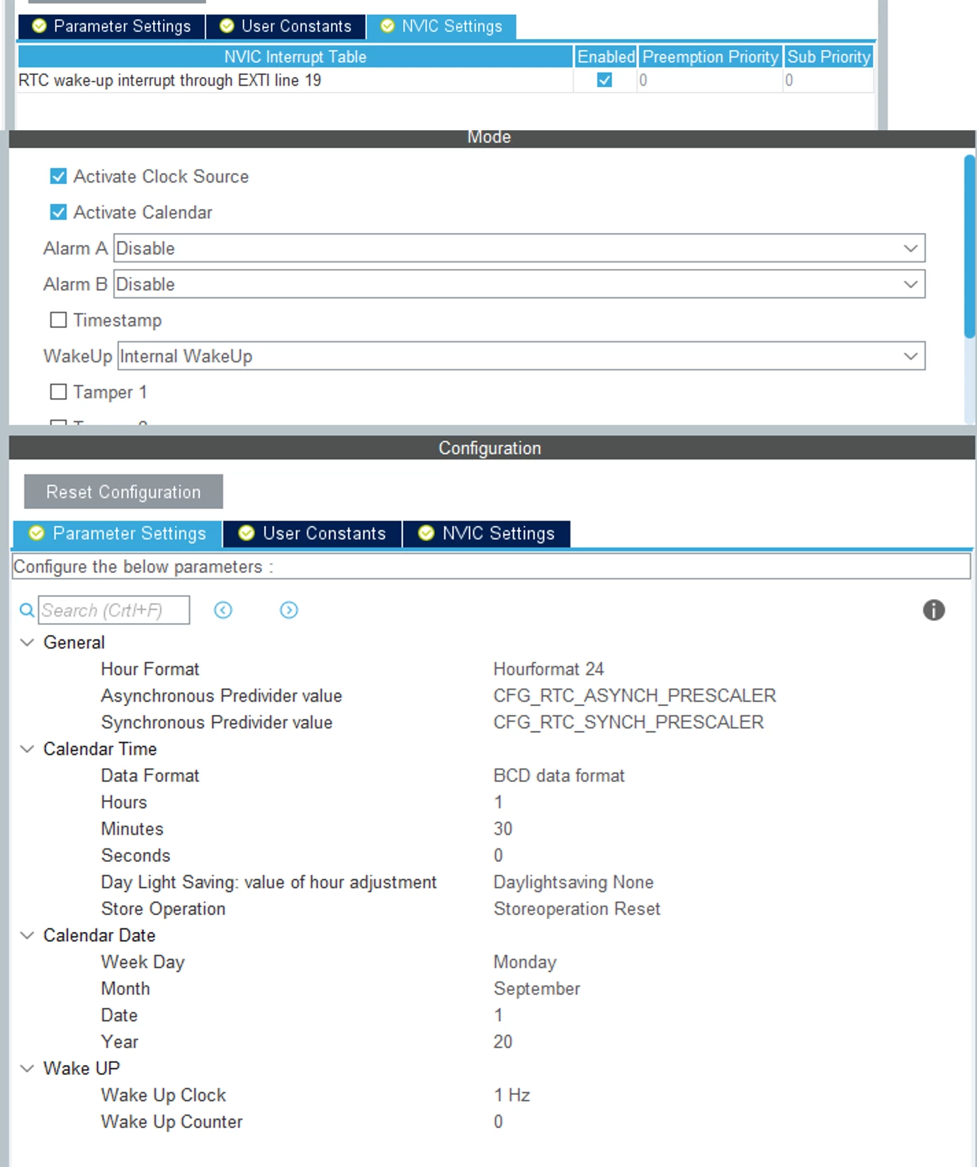

Hello! I have configured the RTC in cube with a frequency of 1Hz in the board STM32WB55, and I want so as to each second the RTC interruption set a task. I found out that I should use RTC_IRQHandler, but in my project I can't found this function, I don't know how to enable RTC interruption, in cube V1.5 I only see the alarm's interruptions. How should I proceed?

First: did you enable the internal wakeup within CubeMX?
Did you also enable the RTC wake-up through EXTI.22 within the NVIC settings?
Then you should put your subroutine in a user code area, e.g. USER CODE 4:
void HAL_RTCEx_WakeUpTimerEventCallback(RTC_HandleTypeDef *hrtc) {
// do something
You probably forgot to activate the NVIC line, right?
Sep 12, 2020 3:12 PM UTC
I have done all that you have mentioned. Here is my configurations
Sep 13, 2020 12:42 AM UTC
I tried to take out APPE_Init(); and UTIL_SEQ_Run(UTIL_SEQ_DEFAULT); and it got working. But I need BLE too
