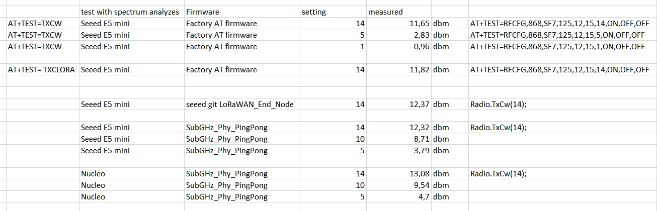

i found the error, it was the clock domain for the one gpio pin that was not right, so the one gpio did not work .. :)
my measurements if anyone could be interested ..
0693W00000NrJXWQA3.pngNucleo is a littel bit better.
Andrew Neil
June 7, 2022
Thanks for the update.
How does a GPIO pin mis-configuration affect RSSI?
Please mark the solution:
spa23
spa23Author
June 7, 2022
Because that it was one of the rf switch control pins, so the rf switch never switched.
Andrew Neil
June 7, 2022
Aha - that'd do it!
