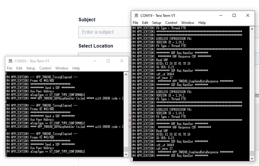

Router having trouble handling frames
I have an OpenThread network with two devices : one end device (STM32WB5MMG) and one router (NUCLEO WB55)
I acquire data with the end device and I try to send 180 000 samples (uint16) to the router
When I try to send, it seems that the router does not handle the data received
Here is the pseudo code sending data for the end device :

Here is the code of the function handling SDF for the router :
static void APP_THREAD_SDFRespHandler(void *pContext, otMessage *pMessage,
		const otMessageInfo *pMessageInfo)
	//TODO Manage SDF response.
	APP_DBG("********* SDF Req Handler *********");
	uint16_t payloadOffset = otMessageGetOffset(pMessage);
	uint16_t payloadLength = otMessageGetLength(pMessage) - payloadOffset;
	otMessageRead(pMessage, payloadOffset, PayloadRead, payloadLength);
	FrameSDF *sdf=(FrameSDF*)&PayloadRead[0];
	APP_DBG("sdf_id %d",sdf->sdf_id);
	APP_DBG("sdf_meas %d",sdf->measure_type);
	free(sdf);
	/* If Message is Confirmable, send response */
	if (otCoapMessageGetType(pMessage) == OT_COAP_TYPE_CONFIRMABLE) {
		//TODO Send Response
		APP_THREAD_CoapSendDataResponse(pMessage, pMessageInfo);
Here are the logs of both devices (end device on the left / router on the right) :
As you can see, the router is blocked and the end device continues to send data
The error occurring for the end device (err code = 2) is a message drop
I progressively remarked latency for the end device while sending
Do you what could prevent the router to receive data ?
Do you know why the router stays blocked ?
PS : acquisition part and frame allocation was checked and does not seem to be problematic
These two devices are the only devices of the network
