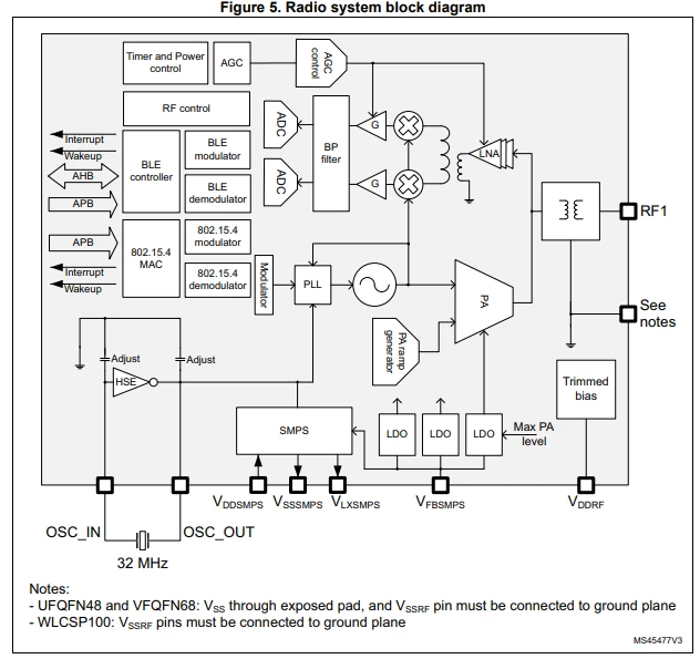

The datasheet for STM32WB55RG (DS11929, 3.6.1 RF front-end block diagram, page 22) states that the output power is user programmable:
"In Transmit mode, the maximum output power is user selectable through the programmable LDO voltage of the power amplifier. A linearized, smoothed analog control offers clean power ramp-up."
The figure 5 in reference manual RM0434 shows a Max PA level input to the LDO but I can't find the register to set this value.0693W00000Bb3r6QAB.png
How do I program the RF transmit power on a STM32WB55 ?
Thanks for considering my request.

Jun 15, 2021 4:23 PM UTC
tBleStatus aci_hal_set_tx_power_level( uint8_t En_High_Power, uint8_t PA_Level );

Thank you. I forgot to say I am using the Zigbee stack. I assume from your answer that the TX power is set by the M0 coprocessor and accessible only via the stack's specific API. Your answer hinted that I should look into the ZSDK API documentation (AN5500) where I found the following:
bool ZbNwkIfGetTxPower(struct ZigBeeT *zb, const char *name, int8_t *tx_power)
bool ZbNwkIfSetTxPower(struct ZigBeeT *zb, const char *name, int8_t tx_power)
Unfortunately, I can't find what's supposed to go in the parameter name. I tried to pass NULL assuming they may be a default behaviour. I also tried to pass a pointer to the value 0, because interfaces are refered to by index in ZbNlmeGetInterface().
I would also need to know how to transform tx_power to dBm. Shall I assume the scale is identical to that of the ACI interface?
A google search on the function name lead me to this unanswered thread: https://community.st.com/s/question/0D53W00000LEgFJSA1/how-did-settxpower-for-stm32wb55-run-zigbee

After a brief exchange with ST support:
  • TX power after reset is 0 dBm
  • name must be "wpan0"
  • tx_power is the level in dBm, in the range [-20, +6]
For example, to set the maximum tx power:
 if( ZbNwkIfSetTxPower(zigbee_app_info.zb, "wpan0", 6) ) {
 APP_DBG("Max tx power set");
 } else {
 APP_DBG("Error while setting tx power");
