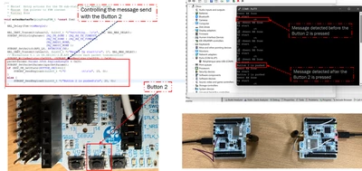

So first I started with the STM32F407VG disc1 and I tried to communicate two boards of it using a SI4432 module and I didn't succeed, I tried something else and I bought two Nucleo-32WL55JC1 boards and tried to communicate them and it works as shown in the last post.
It works as a ping pong application -you can find a better description about this application in this link page 44- after that I tried by developing the same code of the ping pong application to communicate a nucleo-32wl55jc1 with nucleo-32wl55jc2 because in the datasheet they don't use the same frequency but it works!

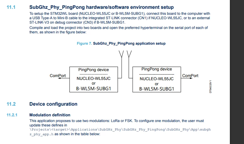

The second one is if the code of the PING PONG application forces me to use only NUCLEO-WL55JC boards or B-WL5M-SUBG1 device?

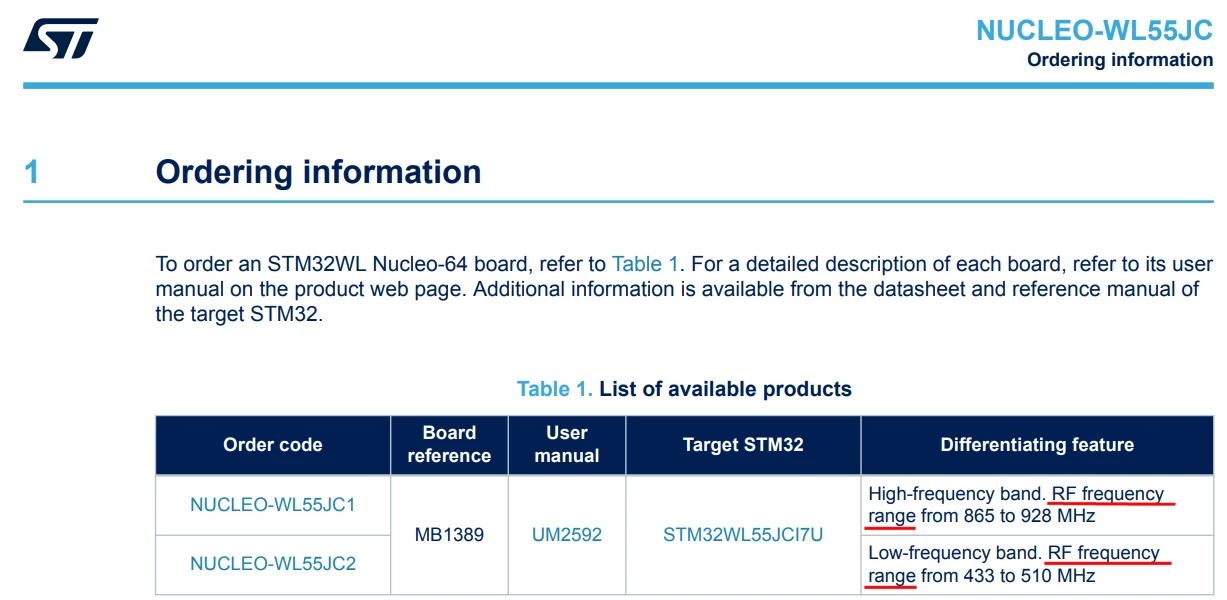

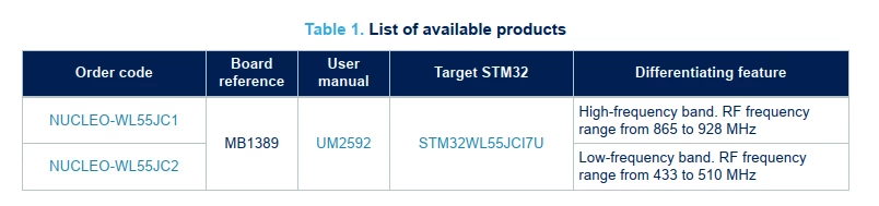

And, what is the meaning of the RF range specified in the data sheet of the NUCLEO-WL55JC boards?

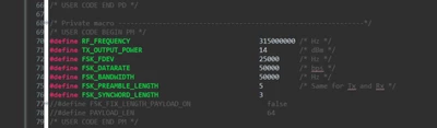

Finally, I tried to communicate with the device that has this configuration
Are these variables the only ones used in the RF configuration? if not, I would appreciate it if you could specify the critical variables that I need to identify in order to program the NUCLEO-WL55JC boards for effective communication.

The Ping Pong application can be configured to fit on any Wireless STM32 MCU or module. You just have to take care of the HW differences on migration.
RF range is the range of frequency that each MCU can use for communication.
The Sub-GHz parameters are all mentioned on the .h files of the SubGHz_phy folder of each Sub-GHz project (Ping Pong for example).
I think ST provides the Ping-Pong example for all of its LoRa-based products - so no, it's not restricted to just WL

May 14, 2024
It actually says, "RF frequency range":
https://www.st.com/resource/en/data_brief/nucleo-wl55jc.pdf
so that's the range of frequencies (from lowest to highest) at which it works.
Not to be confused with "range" in the sense of the distance over which it can communicate!
