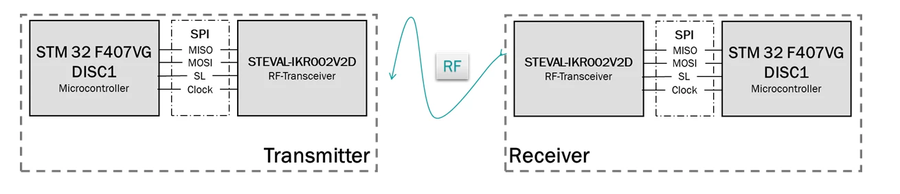

I'm currently working on a project based on transmitting RF.
The objective of the project is to develop a system which is able to communicate with another device based on RF transmission.
The system has to be able to provide RF communication at a frequency in all the sub-1 GHz range.
Now I am trying to use the STEVAL-IKR002V2D that covers the 315MHz, developed by STMicroelectronics, unfortunately I can't find any archive or project examples that use this module.
I would be very grateful if you could suggest me a module (transceiver) developed by ST that can cover all the frequencies needed (315MHz.433MHz.869MHz).
It would also be helpful if you could advise me how to use the STEVAL-IKR002V2D.

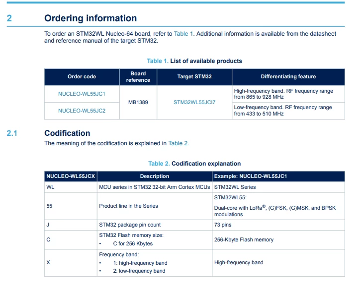

that's what I'm searching about, but i have some questions because i found this on the NUCLEO-WL55JC's datasheet
RF transceiver is available on the 150 MHz to 960 MHz frequency range or not and why I can this range not available on the STM32WL55JC1 or STM32WL55JC2
Issamos
Aug 25, 2023 3:53 PM UTC
Hello again @Zayoud ,
The STM32WL55JC1 cover the high band (between 865MHz and 928MHz) and the STM32WL55JC2 cover the low band (between 433MHz and 510MHz).
Best regards.

Aug 29, 2023 8:48 AM UTC
Hello again,
The easiest way to do what you are looking for is to use the the STEVAL-IKR002V2D. You can easily connect it to the the STM32WL  using his spi interface. You can control this shield using the X-CUBE-SUBG1 driver sense it is based on the spirit1.
Best regards.
