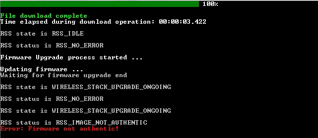

Hi
In my case the programming of the FUS with your proposed command line end in the following output:
RSS status is RSS_IMAGE_NOT_AUTHENTIC
Error: Firmware not authentic!
What is wrong?
Regards Adrian

Adrian Eggenberger
May 22, 2019
Hi
I was able to fix my RSS_IMAGE_NOT_AUTHENTIC issue by erasing the chip:
1) Set read protection to 0xBB
2) Set read protection to 0xAA (will erase the chip)
Maybe this helps as well in your case.
Regards Adrian

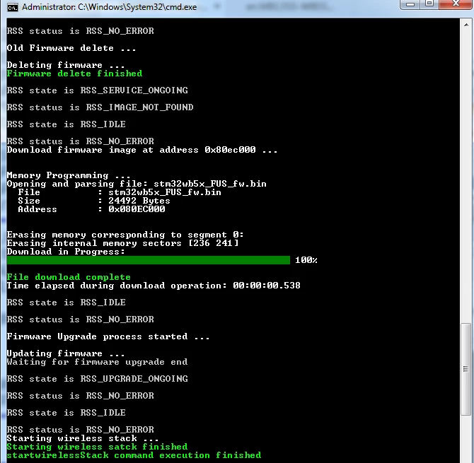

Hi everybody! I had this issue as well.
Fixed it by:
1 - Booting board with BOOT0 connected to VDD.
2 - Connect STLink to SWD of MCU
3 - Target - Erase sectors
4 - Select all sectors and erase
Some last sectors were not erased.
After reboot i was able to flash my IC =)
 Before:
After:
MCope.1
April 10, 2020
Thank you! This worked for me as well. As someone noted above, the "not authentic!" problem started after I tried installing to the wrong start address. I followed your steps and now have it updated.
