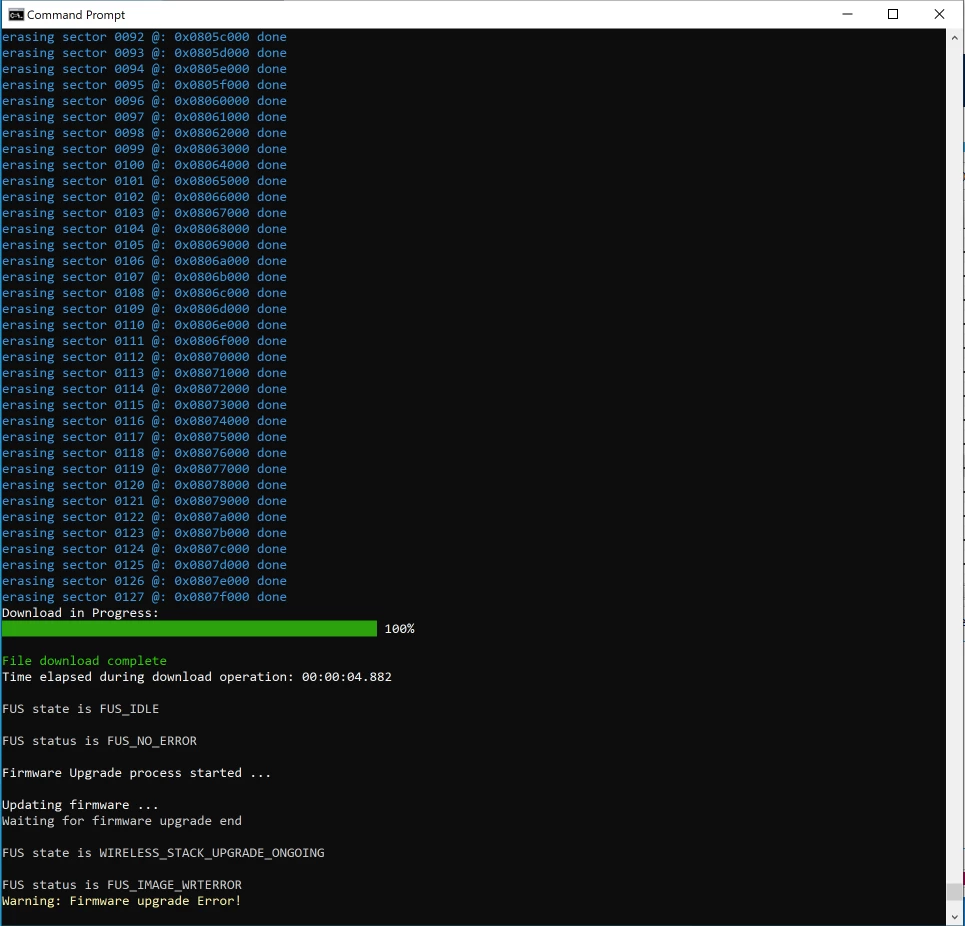

Repeatedly failing BLE firmware update due to FUS_IMAGE_WRTERROR.
I'm running FUS 1.2.0 on an STM32WB55CEU and every time I try to update the BLE firmware over USB I get a FUS image write error. It appears to download and verify successfully but always fails during the actual firmware update. I can't seem to find this error anywhere else on the forum (or Google) so am I the only one having this issue?

 08:59:01 : Download Stack/FUS image at address 0x8053000 ...
 08:59:01 : Memory Programming ...
 08:59:01 : Opening and parsing file: stm32wb5x_BLE_Stack_full_fw.bin
 08:59:01 :  File     : stm32wb5x_BLE_Stack_full_fw.bin
 08:59:01 :  Size     : 183536 Bytes
 08:59:01 :  Address    : 0x08053000
 08:59:01 : Erasing memory corresponding to segment 0:
 08:59:01 : Erasing internal memory sectors [83 127]
 08:59:02 : Download in Progress:
 08:59:06 : File download complete
 08:59:06 : Time elapsed during download operation: 00:00:04.813
 08:59:06 : Verifying ...
 08:59:06 : Read progress:
 08:59:10 : Download verified successfully
 08:59:10 : FUS state is FUS_IDLE
 08:59:10 : FUS status is FUS_NO_ERROR
 08:59:13 : Firmware Upgrade process started ...
 08:59:13 : Updating firmware ...
 08:59:13 : Waiting for firmware upgrade end
 08:59:17 : FUS state is WIRELESS_STACK_UPGRADE_ONGOING
 08:59:17 : FUS status is FUS_IMAGE_WRTERROR
 08:59:17 : Firmware upgrade Error!

Well, I didn't really find the root cause but I've at least found a work around. All the failures were happening when I tried to update through USB DFU. I was also powering the board through USB. This board also has test point access to the SWD pins so I changed my set-up to power the board with an external power supply and connect STM32CubeProgrammer via SWD and now it programs successfully. There is obviously some sort of hardware issue with my USB connection.

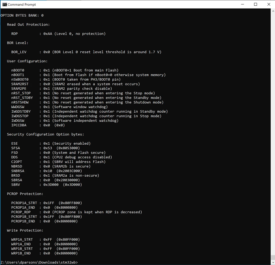

Same failure from command line and option bytes...
