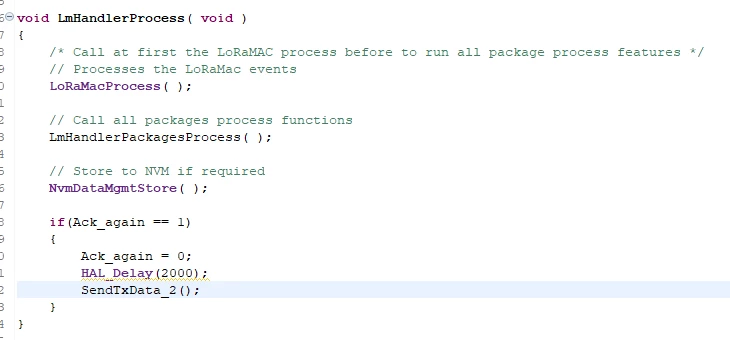

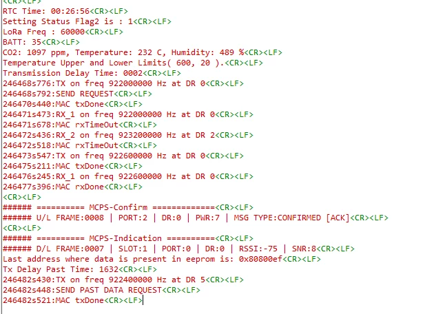

    This code is working on stm32 sequencer so I am not able to send 2nd packet before the completion cycle of 1st data. If I am doing so my code is getting stuck.
    I am sharing the snapshot of log.
    I am sharing the code in which I am calling the function for 2nd data transmit.
    Please help me out.

    Hello again,
    You should do both transmission in the same function separated by a delay to make sure that the sequencer authorise both transmission. Else, you should modify the sequencer's parameters to execute both functions.
