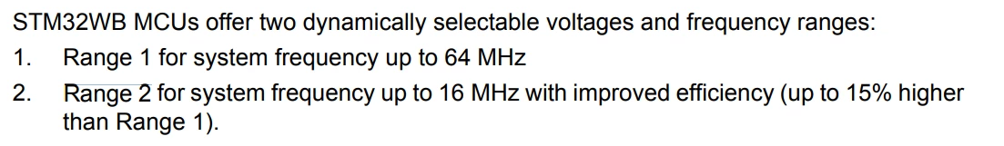

I found range 2 mode can reduce energy consumption quite a lot.
So, I want to try to use range 2 but how to switch it? just change frequncy to 16 MHz?
IIRHO.1
Jul 31, 2023 3:37 PM UTC
Hello again,
you can find details you look for in this Reference Manual .
Best Regards
