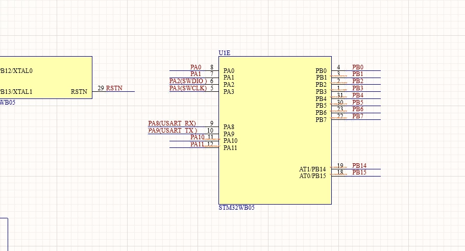

I am using an STM32WB05KZ on a custom PCB. Initially, I was able to program it normally via SWD using STM32CubeProgrammer, but after uploading a BLE Beacon example, I can no longer connect to the MCU.

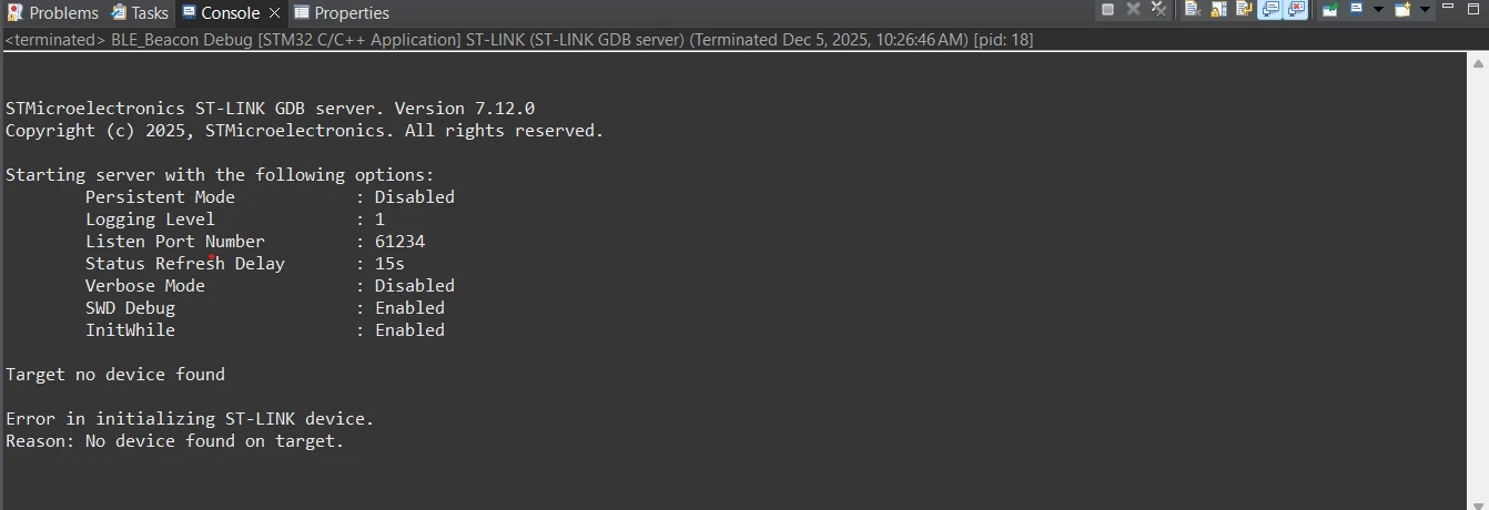

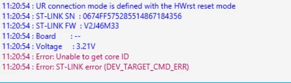

CubeProgrammer now shows:
  • Error: Unable to get core ID
  • Error: ST-LINK error (DEV_TARGET_CMD_ERR)
  • No STM32 target found

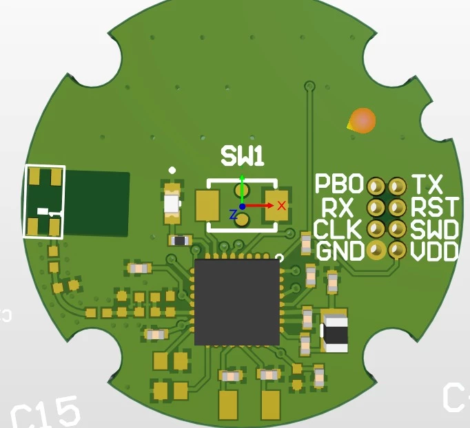

  • SWDIO, SWCLK, RST, VDD, GND routed through through-hole pads

  • Tried Normal, Hotplug, and Under Reset modes
  • Tried holding RESET while connecting → no success
My Situation
After flashing the BLE firmware, SWD stopped responding completely.
It seems the firmware reconfigured the SWD pins early or put the device into DeepStop, which disables SWD access.

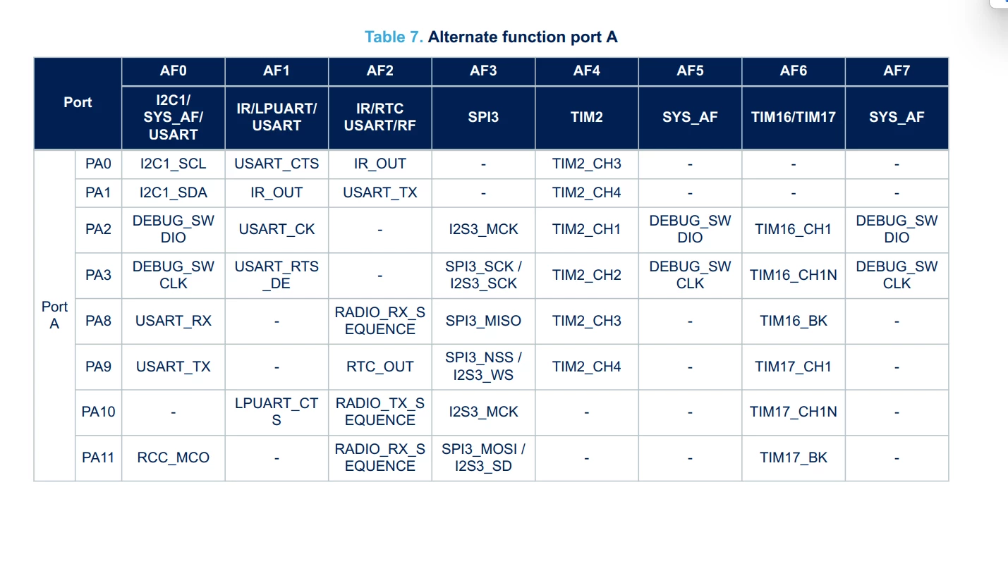

I saw advice suggesting to force the chip into the UART bootloader by pulling PA10 HIGH and resetting.
However, since I designed a custom PCB (not the NUCLEO-WB05KZ), I manually tie PA10 to VDD and then reset, but SWD still does not reconnect.
I have attached the PCB pinout and SWD/UART wiring for reference (in the actual forum post).

TDKBest answer
Dec 5, 2025 1:59 PM UTC
See AN2606 for ways to boot up into the bootloader. Once in the bootloader, SWD will work.
If none of those are feasible, you will need to try to hit "Connect" on STM32CubeProgrammer right after power is applied and before the firmware goes into low power mode. Depending on your program, this may or may not be possible.
Those are the only options.
2 replies
TDKBest answer
Dec 8, 2025 4:52 AM UTC
Hi TDK
Thank you so much.It's working.
