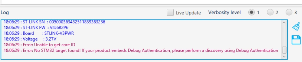

Record the BLE_Ota_reference.hex and I can no longer debug the board or use it in CubeProgrammer
  • May 23, 2025
  • 1 reply
  • 744 views
As described in the subject above, I burned the OTA firmware on the board with the STM32WB55 Microcontroller and I can no longer use CubeIDE or CubeProgrammer because it does not recognize the Debugger (ST-Link). It gives the message below in the image. What really happened? But I can use the ST BLE Sensor App on the smartphone and see the STM_OTA advertising and I can also do the Firmware Upgrade (P2P Application and Heart Rate both adapted to run on FUOTA). Therefore the microcontroller is working well as the BLE Stack too. But unfortunately I can not use the board in CubeProgrammer or CubeIDE and for now I am not finding the solution to solve this. I have already tried changing the mode and reset mode in CubeProgrammer, the voltage is correct, etc.
1 reply
FilipKremen
May 26, 2025
please try to connect BOOT0 pin to VDD.
Best regards,
ST support
