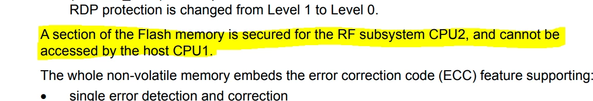

Reading from flash causes hardfault
I'm working with the STM32wb55ceu MCU which states that it has 512K of flash memory starting from address 0x08000000.
However, I realized that if I compile and run the follow program, it will hard fault when attempting to read the value from flash (line 3)
void main ()
 uint8_t i = *(uint8_t *)0x0806f18c;
 (void)i;
 while (1);
To my understanding, the flash should end at 0x08080000. and I have confirmed that my flash memory size is 512K by using the st-info utility.
Is there some sort of memory protection I need to disable?
TDKBest answer
Mar 2, 2022 1:25 AM UTC
0x0806f18c is near the end of the flash.
You're probably reading FLASH that is reserved for the second core (CPU2) handling the wireless functions.

If you dump the faulting address in the Hard Fault handler, what does it report?
Unwritten FLASH may fail ECC checks

Looks like BusFault Status Register contains 0x82 which means BFARVALID is set and PRECISERR
if this is what you were asking
From the datasheet:

Makes sense. I missed that in the data sheet. Thank you.

Read out FLASH_SFR to verify what's reserved for CPU2.
