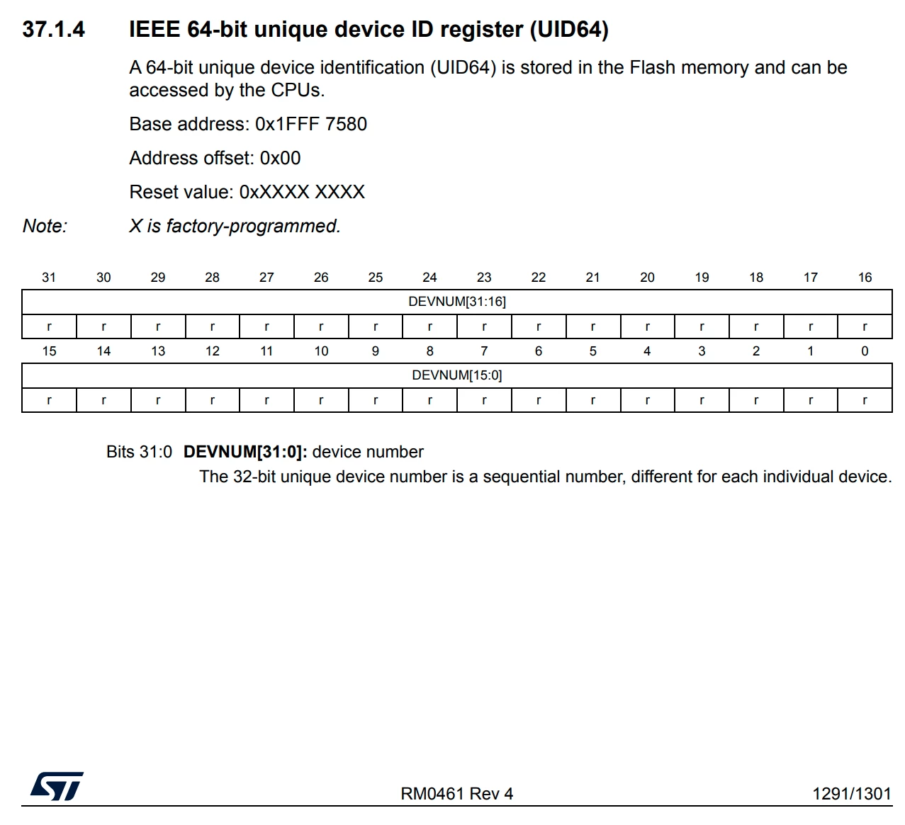

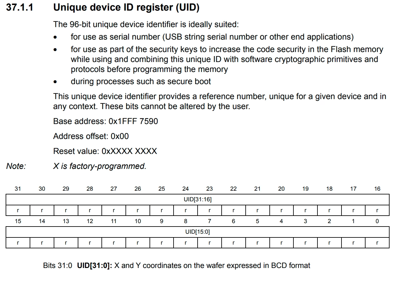

Read STM32WLE5C8U6 & STM32WLE4CCU6 UID
I'm working on the two MCU's STM32WLE5C8U6 & STM32WLE4CCU6 and I need to know the UID in order to indentify each of the products.
In the doc it's written that both have UID but there is no address to read them.
What I'm missing ?
Best regards,
TDKBest answer
Nov 10, 2021 4:31 PM UTC
Locations for both the regular 96-bit UID and the UID64 are found in the reference manual.

ABric.2Author
Nov 10, 2021 4:33 PM UTC
Thank you for the reply, that's what I need.
