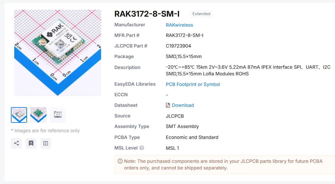

  • Two devices are physically/electrically identical (same PCB revision, same firmware binary flashed via the same build)
  • Planning to physically swap the RAK3172 module between the two boards next to isolate whether the fault follows the module or stays with the board — will update this thread with results
  • Happy to share full AT firmware version / build config if useful
Photos of RAK3172 modules
