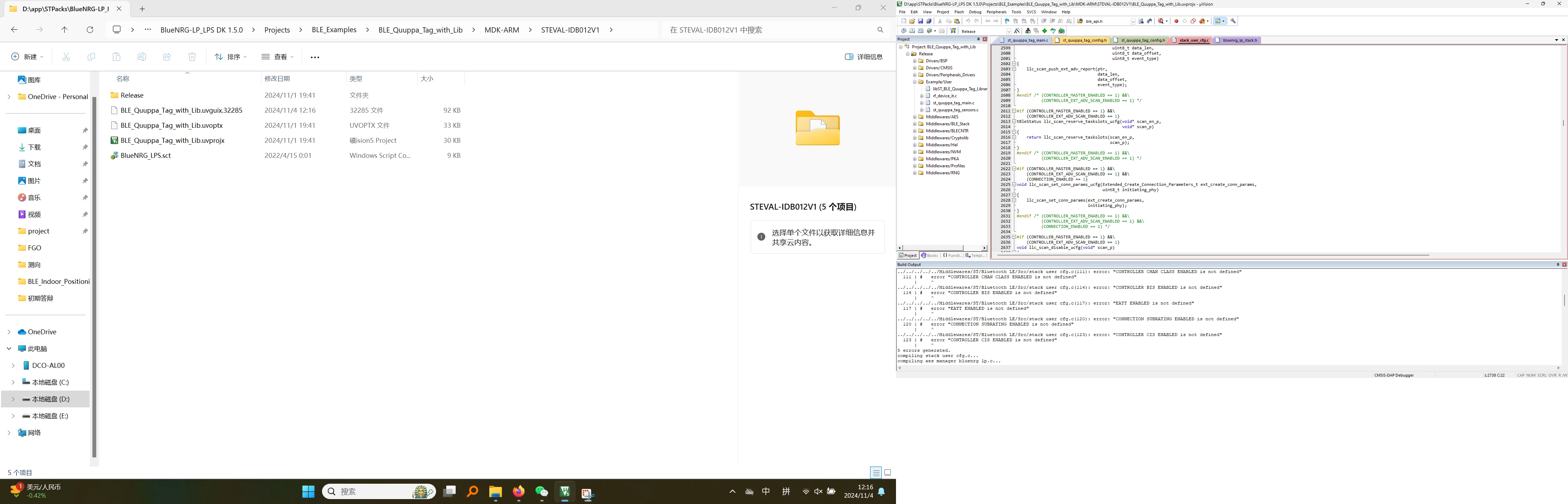

We have purchased the STEVAL-IDB012V1 evaluation kit. On ST's official website, we found a software package for QUUPPA tag emulation using BlueNRG-LP/LPS (en.STSW-QUUPPA-ETAG.zip). After downloading, we extracted it into the BlueNRG SDK (STSW-BNRGLP-DK). However, when I tried to compile the project using Keil, I encountered errors. The error details are shown in Attachment 1.
![](./STEVAL-IDB012V1.png) STEVAL-IDB012V1.png
The version of Keil I am using is 5.40, and the compiler version is 6.09.
I could not find a detailed solution to this issue in your forums or documentation. Additionally, there is no detailed explanation of the purpose of this project, only a brief mention that it is a "QUUPPA tag emulation."

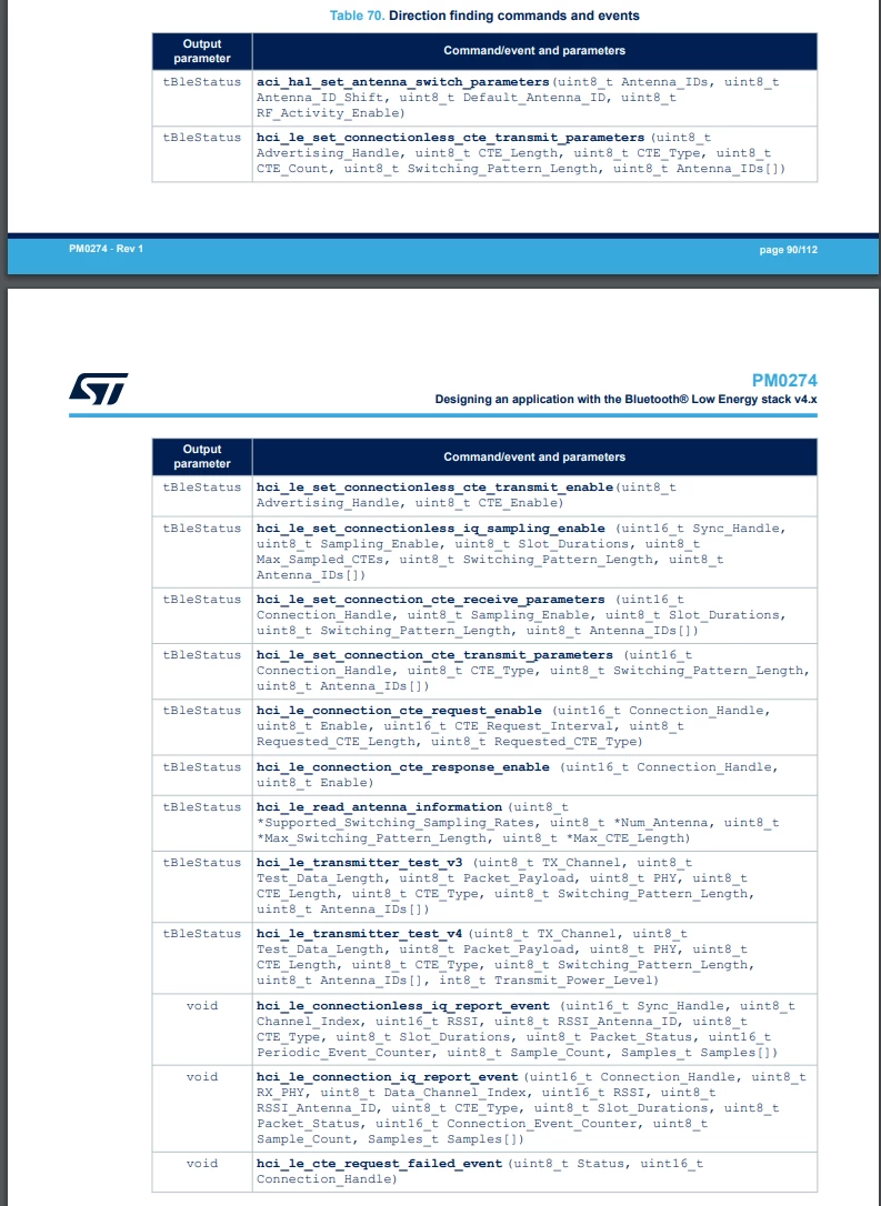

### 4. About Implementing AOA Positioning Using Code (This is the Most Important Point)
We want to design a base station using the STM32WB09 for direction finding in connectionless scenarios.
However, you have only provided a limited number of APIs, and I cannot see the implementation of these functions.
![](./aoa_hal_api.png) aoa_hal_api.png

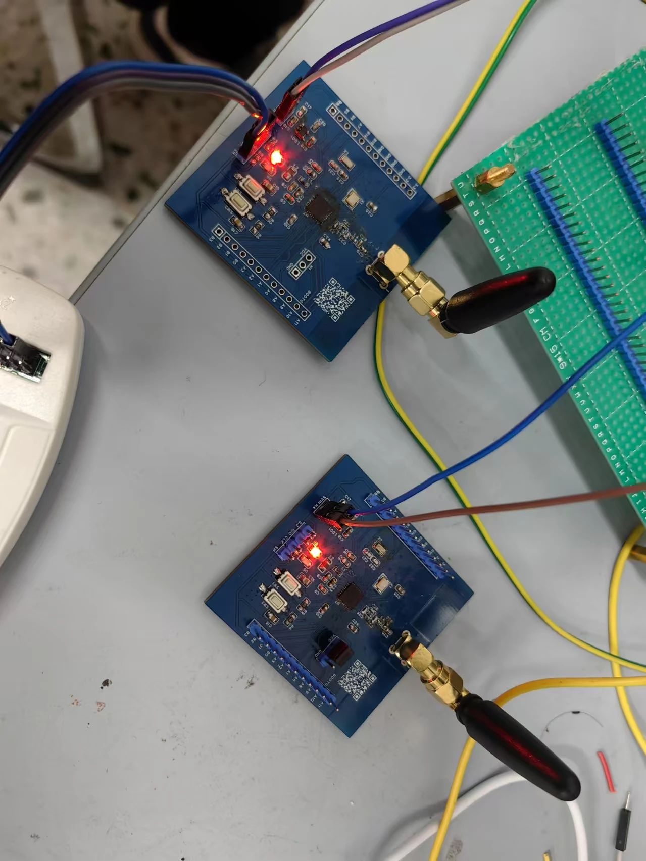

I used two custom STM32WB09 development boards to test the `BLE_Beacon_AoA_Tag` and `BLE_Beacon_Scanner_AoA_Locator` examples from the SDK.

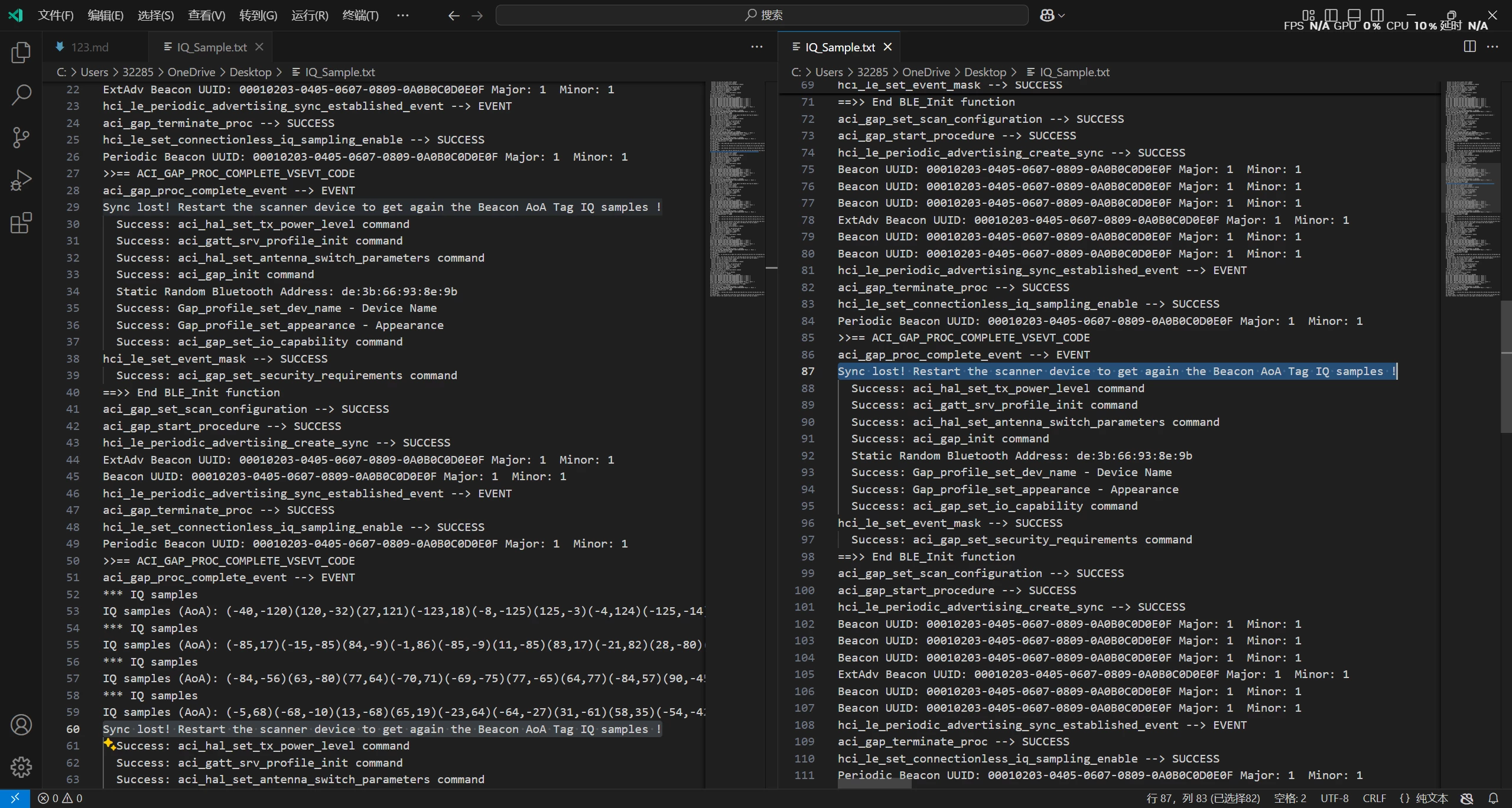

I was able to receive IQ data via the serial port, but there is a serious issue:
![](./error.png) error.png
After receiving a small number of IQ samples, the following error is triggered:
```c
case HCI_LE_PERIODIC_ADVERTISING_SYNC_LOST_SUBEVT_CODE:
APP_DBG_MSG("Sync lost! Restart the scanner device to get again the Beacon AoA Tag IQ samples !\r\n");
//device_state = START_SCANNING; //TBR???
I noticed that you might have intended to restart the scanning process, but the code is commented out, and the "TBR???" comment is left in the official SDK release. Is this a hardware design issue causing the connection to drop?
