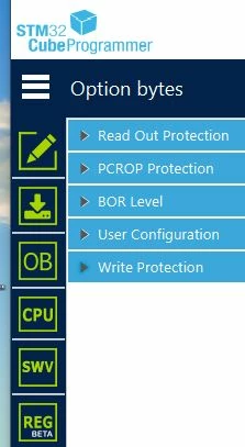

Q. to write protection area on bank1 ?
Hello, I am new to the STM32 world.
my little board STM32 (LoRa) form China
ST-LINK SN : 53FF6D066687505145250967

  Write Protection:
   WRP1A_STRT  : 0x0 (0x8000000)
   WRP1A_END  : 0x1 (0x8000800)
   WRP1B_STRT  : 0x7F (0x803F800)
   WRP1B_END  : 0x0 (0x8000000)
OPTION BYTES BANK: 1
Q.: I cannot start my own program at 0x8000000
How can I remove write protection? or possibly to another Addr. move
Q.: Is there a chance to start my own program on this board?
TDKBest answer
Aug 29, 2021 6:33 PM UTC
You should be able to change WRP1A_STRT/WRP1A_END in STM32CubeProgrammer somewhere within the option bytes.

Do you have a tip in which area of the STM32 Cube Programmer it can be switched off
Or setting a new Startaddr. for Programs?
TDKBest answer

Aug 30, 2021 5:41 AM UTC
@TDK, thx that works for me.:grinning_face:
