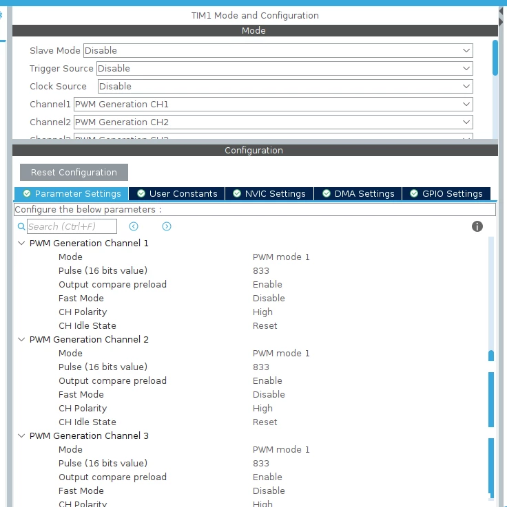

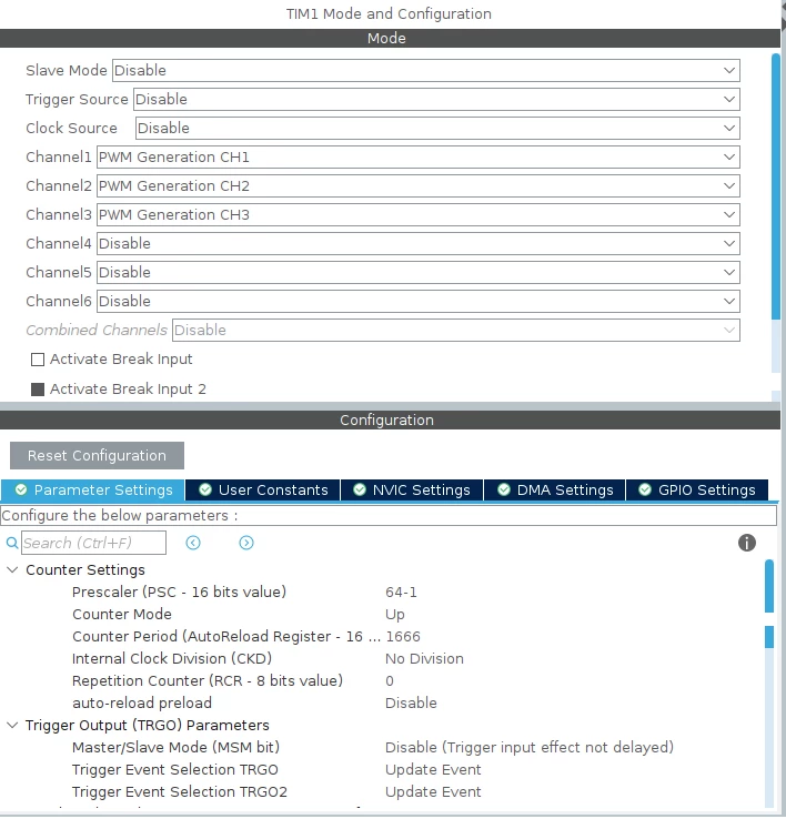

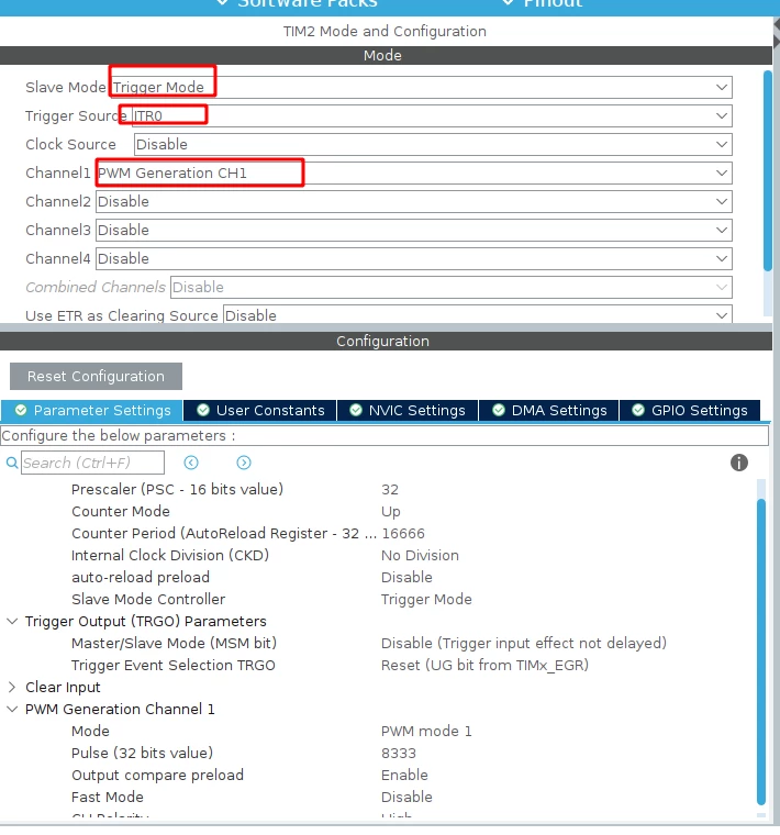

 2.I used the hardware timers directly to generate the PWM signal But there is phase shift after two or three pulses
Below is the configuration for PWM using slave trigger concept.

Jul 8, 2024 5:57 PM UTC
There is a phase shift when using the timer hardware?  Is this between the 3 signals from TIM1 or between the TIM1 signals and the TIM2 signal?  Either way, if the timers are free running I would not expect any change in phase relationship.  Are you starting or stopping the timers to toggle your "CAM_TRIG" signal?
