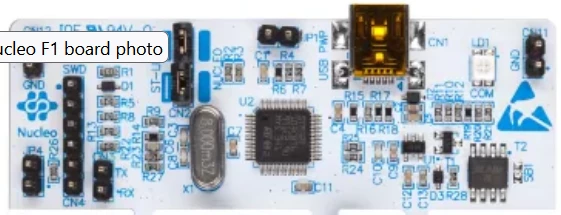

I would like to write C code for the above board.  From reading, I believe the steps are as follow.  Appreciate if you may help to see if any issue.   TIA
1. I have Nucleo F103RB (and also F401RE) to be used as ST LINK programmer
2. I did firmware upgrade to Nucleo F103 and it is now ST-LINK V2 FW : V2J42M27 Debug + VCP.  It will work right?  Although the Nucleo WL5JC board has ST Link V4.
3. I plug in the Nucleo F401 and hit the "update firmware" buttom. Current firmware is V2J43M28. It suggests to "update" to V2J42M27 Debug + mass storage + VCP.  Strange the suggest upgrade is one number *LOWER* ?
The Nucleo F103 also suggests upgrade to one number LOWER and I did it.   I have not yet change the Nueclo F401.
3. From UM1724, user manual of Nueclo F103, Remove two jumpers on CN2 connector.  CN4 will become six-pin SWD to be connected to the STM32WL5JC target board.
4. Does pin 1 on Nueclo F103 and F401 outputs 3.3 volts to power the target STM32WL5JC?
