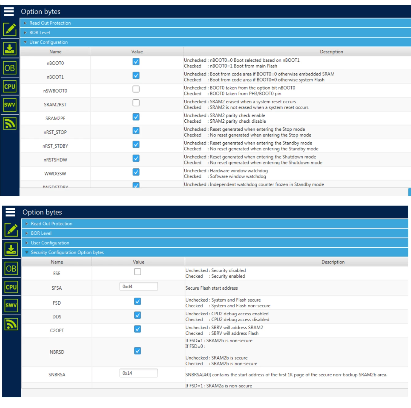

Remi QUINTIN
Oct 26, 2020 4:59 PM UTC
​The READ FUS STATE boxes remain empty as this information is not accessible using the SWD port for now.
Now could you send a picture of the option bytes, especially the security ones.
I want to check is the ESE bit is set.
How old is the board?
RPowe.9.306
Oct 26, 2020 8:19 PM UTC
Hi Remi,
The board is 2 or 3 years old, I got it a 1-day workshop in Bristol when the WB55 was pretty new. See attached, the ESE bit is cleared

RPowe.9.306
Oct 26, 2020 8:29 PM UTC
Hi Remi,
The custom board was made this year so I assume the chips are very recent. See attached for option bytes. The ESE is set on this chip. If I try to clear it, I get the message "Warning: Option Byte: ESE, does not exist" - very odd
Remi QUINTIN
Oct 26, 2020 10:00 PM UTC
​ESE = 0 means this board is not a secure one. So Firmware Upgrade Service (FUS) is not available to upload new FUS or new encrypted RF stack.
So hard to commit on any predictable result. No FUS => No info on the FUS => No way to download anything in a secure way.
You can use this board to run your own SW (application + own RF stack) but no way to protect it and this configuration will never be used for production.
RPowe.9.306
Oct 27, 2020 10:19 AM UTC
Hi Remi,
This is just a Nucleo so it's not for ever going to be for production. I have another Nucleo with an old stack and an old p2p server app. I was just hoping to load this Nucleo with the latest stack (stm32wb5x_BLE_Stack_full_fw.bin) and a new version of the p2p server. Are you saying that is not possible?
Remi QUINTIN
Oct 26, 2020 10:03 PM UTC
When ESE = 1, it is not possible to modify the value. The error message sounds a bit weird but in the end no way to roll this chip back to an non-secure configuration.​
Remi QUINTIN
Oct 26, 2020 10:05 PM UTC
SFSA = F4 => The FUS is at least v1.0.2. May even be v1.1.0. For sure no RF stack is intalled on this device.​

Remi QUINTIN
Oct 27, 2020 2:18 PM UTC
stm32wb5x_BLE_Stack_full_fw.bin is an encrypted stack and only a FUS has the correct key to ensure a proper decryption and installation.
When a chip is not secure (ESE = 0) , there is usually no primary FUS loaded on it.
Remi QUINTIN
Oct 27, 2020 3:17 PM UTC
1) Whatever the programing port use to install an encrypted FW, a FUS is required. Programing commands are sent to the FUS either via the bootloader when the UAS/UART port is used or via the FUS operator when the SWD port is used. The FUS operator is a small piece of code loaded at the start of the Flash memory that transmits the commands to the FUS.
2)Yes! The FUS is used to install a new FUS version (older than the current one) or a new RF stack.
3) Not exactly. It all depends on the FUS version and the RF stack version. It is always recommended to install the RF stack of a CubeWB SW package with the FUS available in that package. But you can install a RF stack v1.7 with a FUS v1.1. for example. I don’t think it would work with a RF stack v1.3 or 1.5.
The description of all the FUS version is available in the table 1 of the application note AN5185.
