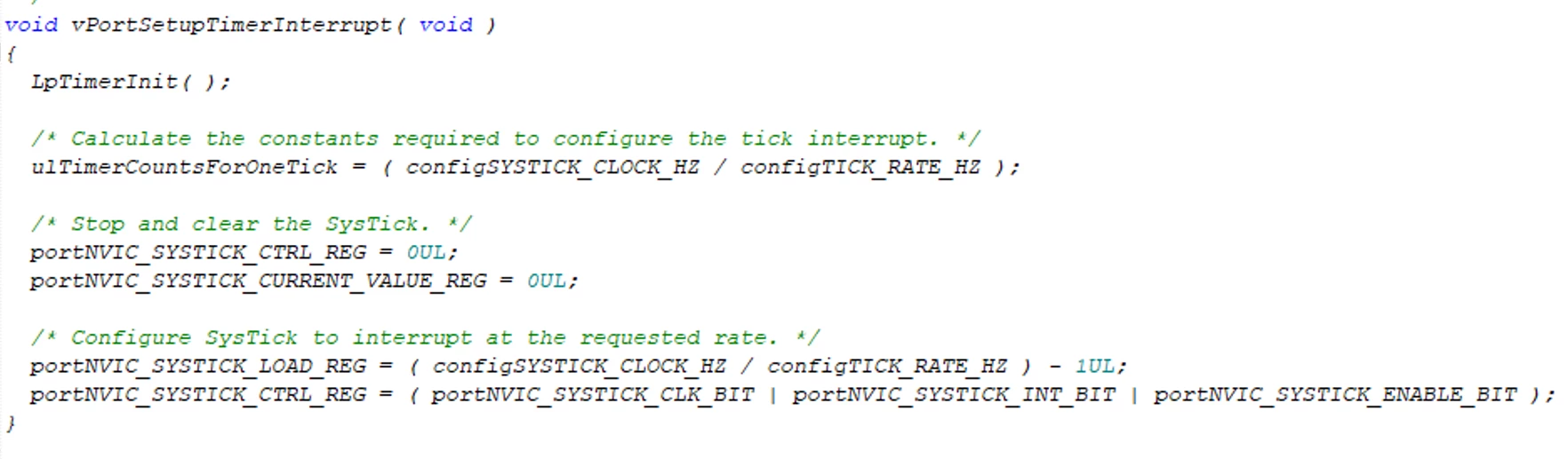

Hello! I have a project where I set up the BLE , then I decided to add FreeRTOS to this project. But the problem is that there is an error in the generated project that I cannot solve (It seems the error is from Cube).
(...).axf: Error: L6200E: Symbol vPortSetupTimerInterrupt multiply defined (by port.o and freertos_port.o).

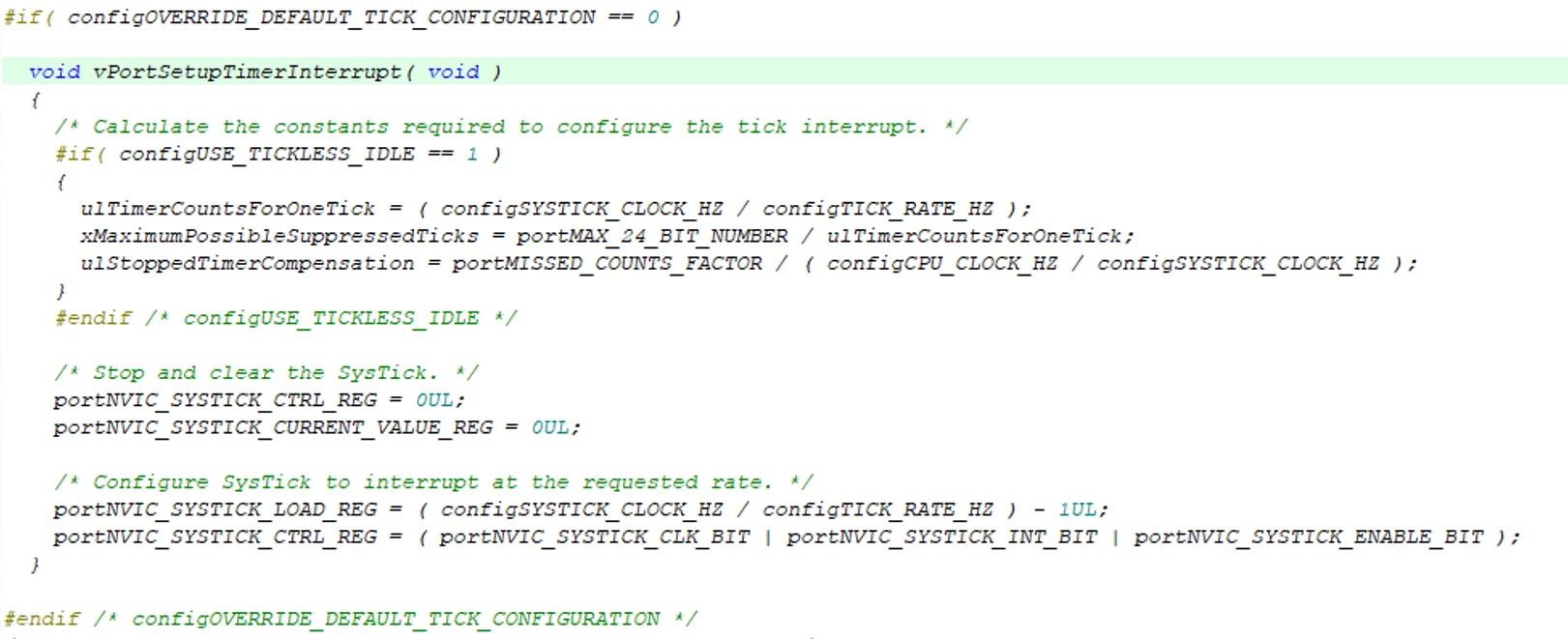

when I open this files I see that there are two implementations
im freertos file
0693W000004HLhpQAG.pngand this is port file
They are not declared globaly. When I comment one of them, I get two new errors, when I seattle these new errors, I get news one. How to end up with this?

hello, @Nesrine.JLASSI​  I could solve the problem but not sure if it is the right way: in Cube . in project manager , I increased the minimum Heap Size and the minimum Stack size to 400 and 1000 respectively. When I generated the code, the error came once again and in file freertos.c I renamed the annoying function and the compilation runned without any erros.
The second way through what I solved it was generating to CubeIDE , I increased heap and stack size then there was no need to rename the functions after generation

As a Workaround you can set configOVERRIDE_DEFAULT_TICK_CONFIGURATION to 1 (in FreeRTOS UI) when using Keil toolchain.
