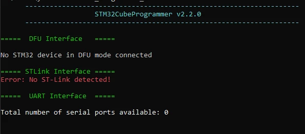

For Nucleo wb55 board, I do exactly as precised in the documentation, I connect CN7.5 and CN7.7 to put BOOT0 to VDD. I connect JP1 to USB MCU and finally, I connect USB cable to USB_USER. I run STM32CubeProgrammer, I switch to USB connection and there I do not see any device in DFU mode. If I do it in command line, I execute the following command "STM32_Programmer_CLI.exe -l" to list all peripherals that I can connect to but it sys me that there is nothing. I precise that I can do both ways with USB dongle in Bootloader/DFU mode and that driver is up to date, it is the 2018 version delivered with last version of STM32CubeProgrammer.

​Your HW settings are correct.
Be sure to close the Cube Programmer (graphical version) before sending any command with the command line interface.
Then run the command STM32_Programmer_CLI.exe -l.
Are you using the last Cube Programmer version V2.2?

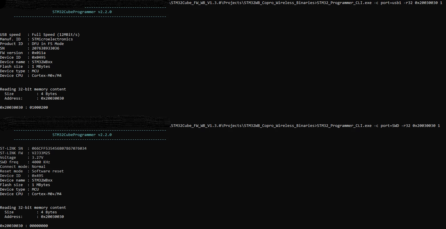

With Cube Programmer V2.2 with SWD and with BOOT0 to 0, I succeeded in flashing successfuly FUS and BLE Stack from 1.3 release firmware package.
But there is still a problem, I can not see FUS version like with USB Dongle with the following command (usb1 is usb dongle connected and SWD is Nucleowb55 connected) :
And when I try to execute "STM32_Programmer_CLI.exe -c port=SWD -fusgetstate", it says me that this command is still not available with SWD, but if I am not wrong, I succeeded to activate FUS in USB Dongle by launching this command twice, but there I cannot so no activation of FUS and then no activation of Wireless stack. Am I doing something wrong ?

​>I can not see FUS version like with USB Dongle
  • When reading version returns 0x000 using the SWD interface?
  • In order to read the version, you need two actions:
    • Enable the CM0+ core
    • Prepare the data structure for the System table addresses in line with IPCCDBA option bytes offset value.
  • When you connect through SWD (under reset most of the time), these two steps are not done and so no version isavailable.
>this command (-fusgetstate) is still not available with SWD
  • -fusgetstate is not available with JTAG operator. It supports only two commands: fwupgrade and fwdelete.

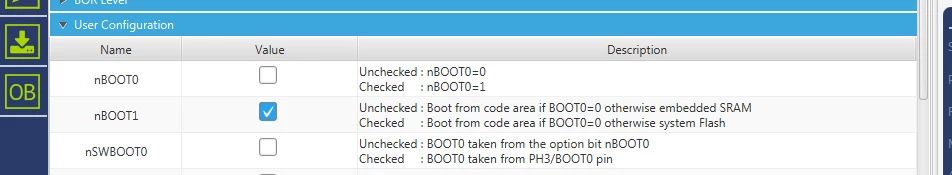

Thanks to support team by email, we found the solution to connect to DFU Mode. Via STLink and STM32CubeProgrammer, I configured user configurations like the following :
That way, it does not rely on PH3 pin and I can connect to custom board and eval board in DFU Mode !
