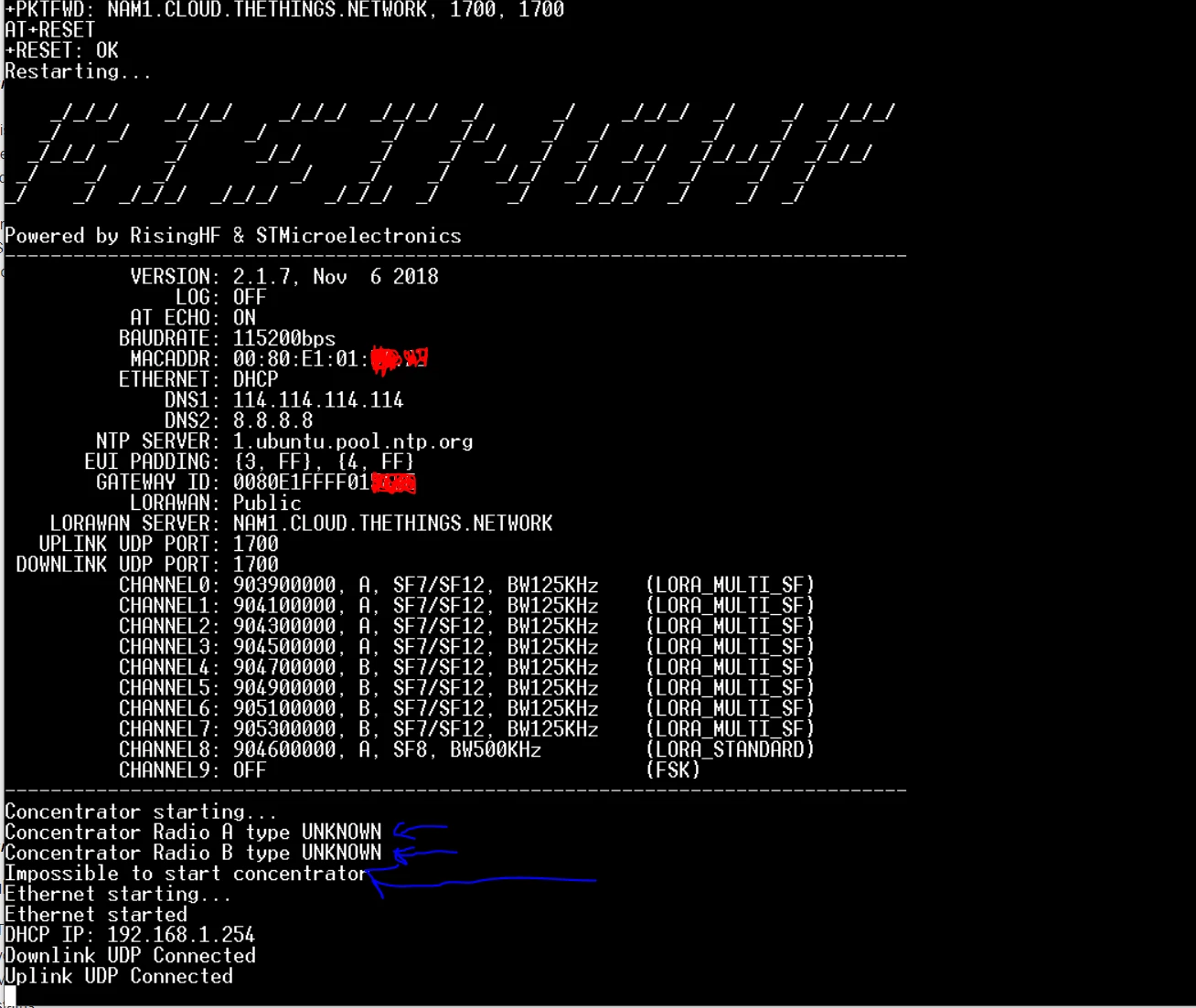

HI. I bought the STM32WL lora HF Package (lora getaway + lora sense)
I programmed the gateway as appear in the youtube here the link
(https://www.youtube.com/watch?v=uJU3YM1MWN4)
It worked well for 1 month, suddenly I lost the signal from the node, and I check the TTN, firmware, APPKEY, DEVKEY, etc, finally, I check the gateway and realized with the following mesage in the log.

Concentrator starting...
Concentrator Radio A type UNKNOWN
Concentrator Radio B type UNKNOWN
Impossible to start concentrator
Ethernet starting...
as you can see the information, RADIO A and B, doesnt appear, could be the board is fail?
well, finally, I re-upload the firmware, erasing the board, upload the .BIN data, ETC, but nothing changes.
Thanks for your help.
Ricardo
2 replies
YBOUV.1
February 23, 2022
Hi @RVasq.4​,
Please contact your local support for replacement. Your GW seems borken.
