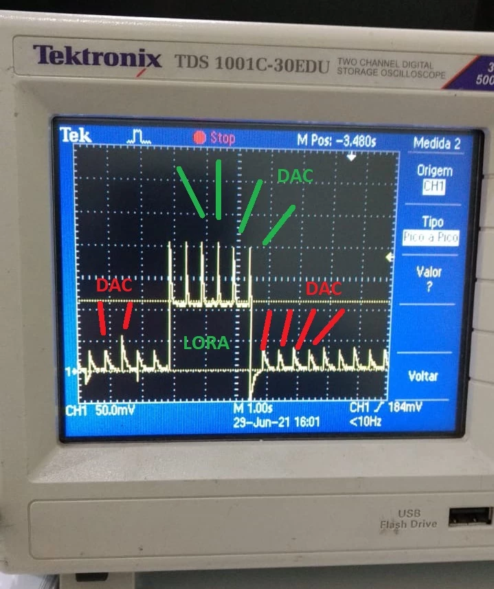

Hi guys. When I program the device with LoRaWAN and DAC with pin extern (PA10), I saw in oscilloscope that DAC stay high every when has uplink. Like the image:
Does anyone have any idea why this happens? Thanks!

Perhaps some issue with the grounding? Any obvious shorts or points of connectivity?
Is this some custom board? Is there are schematic for it?

I use the DAC for the COMP. The DAC Pin is not connected to anything, I just keep measuring it to see the behavior of my firmware... I can't send the schematic :(
