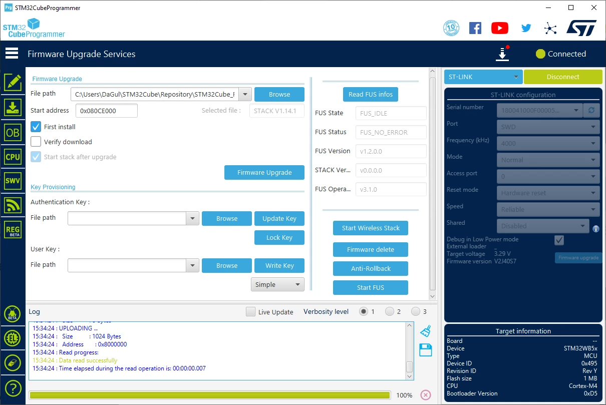

I have a problem updating the Wireless Stack on STM32WB55CGU6 on a custom board. The board is basically a cloned version of the P-NUCLEO-WB55-USBDONGLE. The device is connected via SWD on St-Link/V2.
0693W00000Su5d2QAB.pngFUS Version is already on v1.2 from Factory, but there is no STACK installed.
Whenever I try to install a new BLE Stack, there are two possibilities:
  • Either a ‘Error: FUS_STATE_ERR_UNKNOWN’
  • or everything appears to go fine, showing ‘success’.
But either way, afterwards it appears there is no STACK installed.
This is exactly the same for different Wireless Bundles and different Version Numbers.
I tried 1.13.1, 1.13.3, 1.14.0 and 1.14.1 with stm32wb5x_BLE_Stack_full_fw.bin, stm32wb5x_BLE_Stack_light_fw.bin and stm32wb5x_BLE_Stack_full_extended_fw.bin
The strange part is, that it already worked on one board, doing exactly the same thing!
But it doesn’t matter how many times I try, it doesn’t work on the other boards.
It is exactly the same thing when trying to update the STACK with the CLI Programmer.
Erasing the Chip before trying to update the Stack doesn't seem to make any difference.
The procedure seems to be right, since it already worked on one board. It also worked with different USB_Dongles.
CLI Output will be attached to this post.
Is there anything I’m missing? Any advice would be greatly appreciated.

the problem turned out to be a faulty Power Supply.
Everything is working as it should be.
