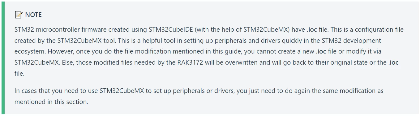

But when we open .ioc file and update something. It will change so many files and due to that we are not able to build the code succefully.

Please make sure to follow all the steps mentioned in your shared link. As mentioned in the following note you cannot update the .ioc via CubeMX unless you repeat all the steps in your configuration after the modification as mentioned in this note.

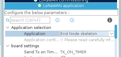

ST CubeIDE/CubeMX has an example application built-in, selected in the Cube options for the LoRaWAN stack ("End Node Skeleton"). So I created a completely new project with Cube for the STM32WLE5 CPU in the RAK3172, porting the GPIO and clock assignments. So I produced this myself using ST-provided framework code combined with RAK3172 code that I wrote myself.
This differs from the RAK-provided low-level code which patches the ST firmware repo; this is easily regenerated after making changes to the project in Cube.
