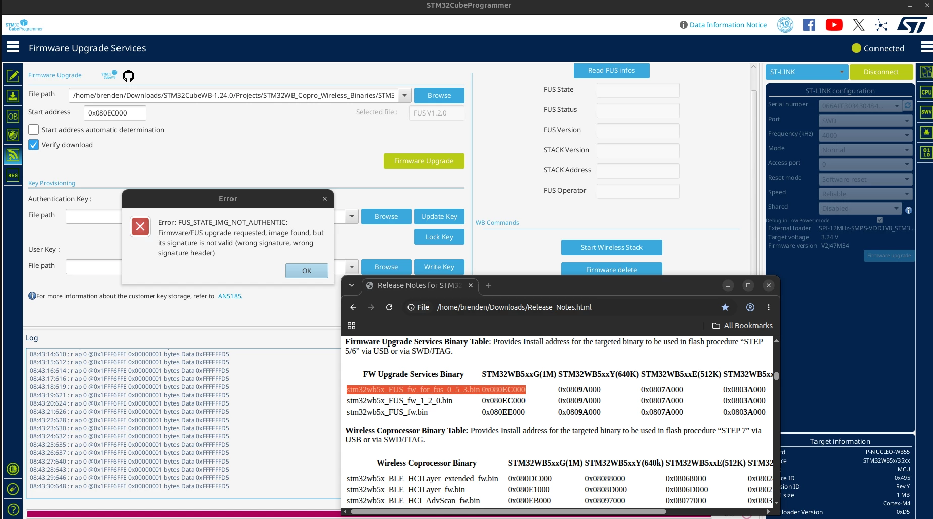

problem updating stm32wb55 with stm32cubeprogrammer 2.22
I’m trying to update the
  • stm32WB55 - nucleo Version (MB1355C)
  • SWD
  • stm32wb5x_FUS_fw_for_fus_0_5_3.bin -- latest from STM32CubeWB-1.24.0
But it keeps failing every-time i do it.
Steps
  • Start FUS
  • check the wireless stack
  • try and flash the first bin file
It just doesn’t seem to want to work?
  • Error: FUS_STATE_IMG_NOT_AUTHENTIC:
It works on the USB sticks when i flash it this way.  So i don’t know what it’s doing wrong?  Or are these bin files only for the USB stick?

So what worked for me was going to the Option bytes menu (OB)
  • RDP - BB
  • RDP - AA
This removed anything on there.  Then flashing

Hello ​@Brenden_PLUS ,
Please have a look at the following wiki pages which describe how to update the wireless firmware:
You can try full chip erase.
Hope that help you.
