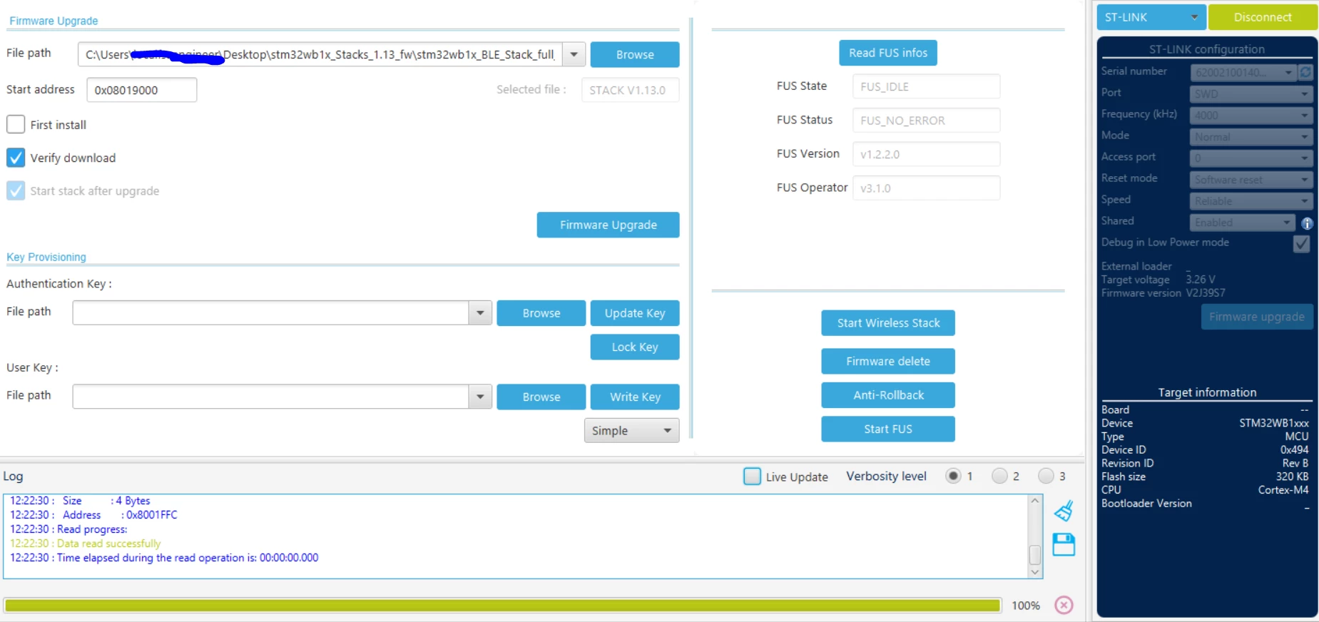

Hi everyone.
I have a problem when I try to load BLE Stack on STM32WB15. I can connected the MCU to STM32Programmer and there can recognize the cortex. At the moment to load the Stack, STM32Programmer send me the configuration about FUS and I cand read it.
But, when I push Firmware Upgrade, STM32Programmer send me the next answer:

The problem is when STM32Programmer trying to reconnected to STM32WB15 but it fail.
Someone have the same problem with the programmer?
Thank

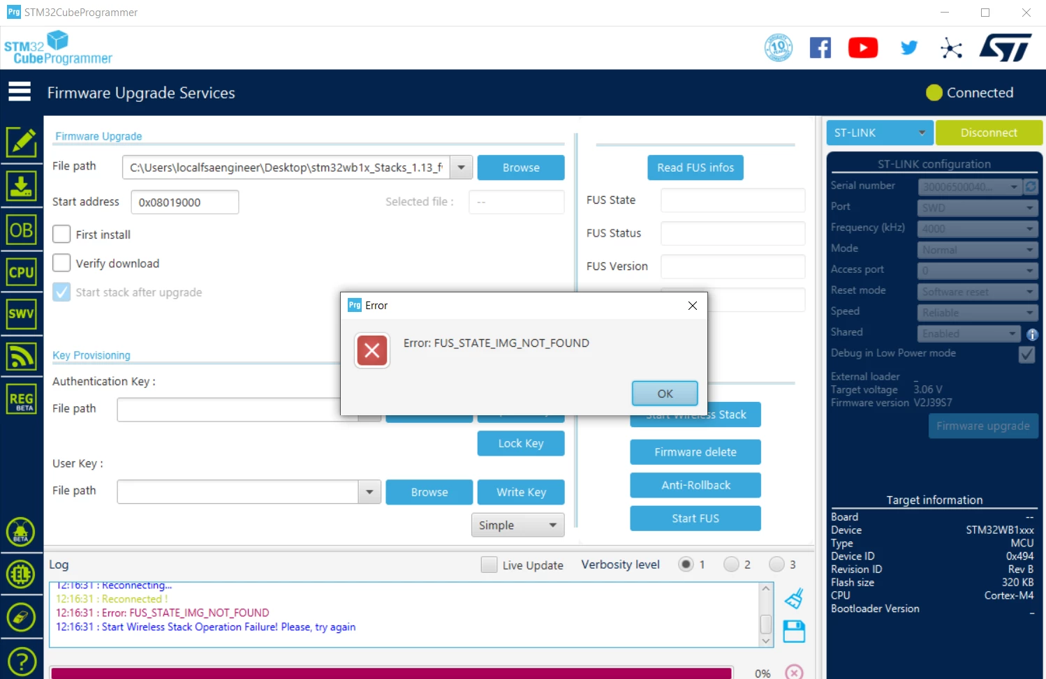

This problem back out again with other Custom PCB that worked before. Now, the STM32Programmer send other error when I try to start the Wireless Stack, the message is:
0693W00000JPRwNQAX.pngThis is so bad because the last version of our custom PCB was working and after "try to load the new BLE stack", it does not work.
