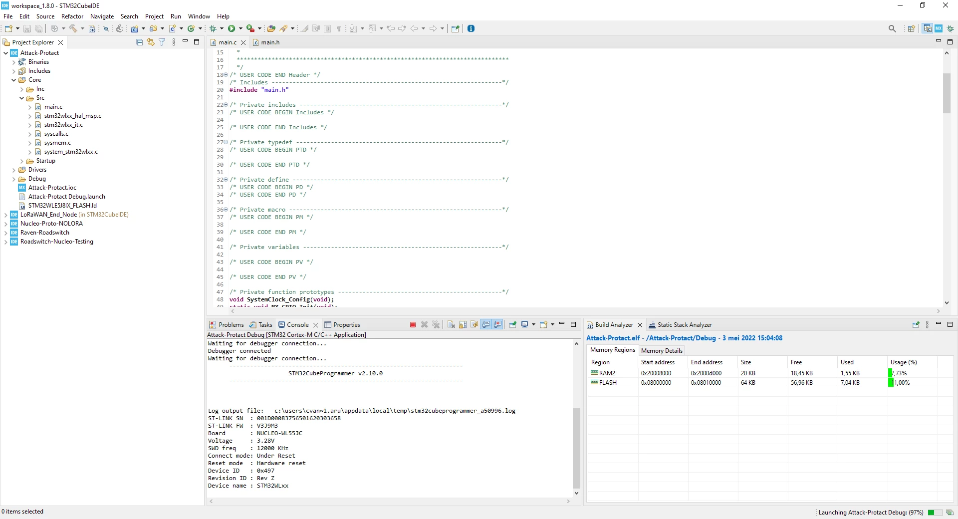

Problem flashing STM32WLE5J8I6, stuck at 97%
Hi all. I've got a problem when trying to flash the STM32WLE5J8I6.
I am trying to run a simple blinky code and blink an onboard LED on my custom pcb.
The program builds fine, connecting with the ST-Link (Nucleo-WL55JC1) and using SWD to connect to the STM32WLE5 works. However, when running or debugging, the program gets stuck at 97%. See picture.
The following output is seen in the console:

For some reason, when i terminate the console and thus the flashing, the console gets expanded to the following:

Boot is pulled up, pulling it down makes it impossible to connect to the device using STM32CubeProgrammer.
Reset is internally pulled up. Only decoupled on the board itself.
Any hints into the right direction are highly appreciated.

Louis AUDOLY
May 10, 2022 8:51 AM UTC
Hello @Cvan .7​ ,
Do you have CubeProgrammer stand alone? If so, do you experience a problem with it?
If you look in C:\ST\STM32CubeIDE_1.8.0\STM32CubeIDE\plugins\com.st.stm32cube.ide.mcu.externaltools.cubeprogrammer.win32_2.0.200.202202231230\tools\bin\STM32_Programmer_CLI.exe directory, is the CLI.exe placed here ?
Best regards
Louis
Cvan .7
Cvan .7Author
May 10, 2022 9:05 AM UTC
Hi Louis,
First off, thanks for your help.
The ...CLI.exe is placed there.
Louis AUDOLY
May 12, 2022 9:49 AM UTC
Hello @Cvan .7​ ,
Have you the same behavior with CubeProgrammer in stand alone ?
Regards
