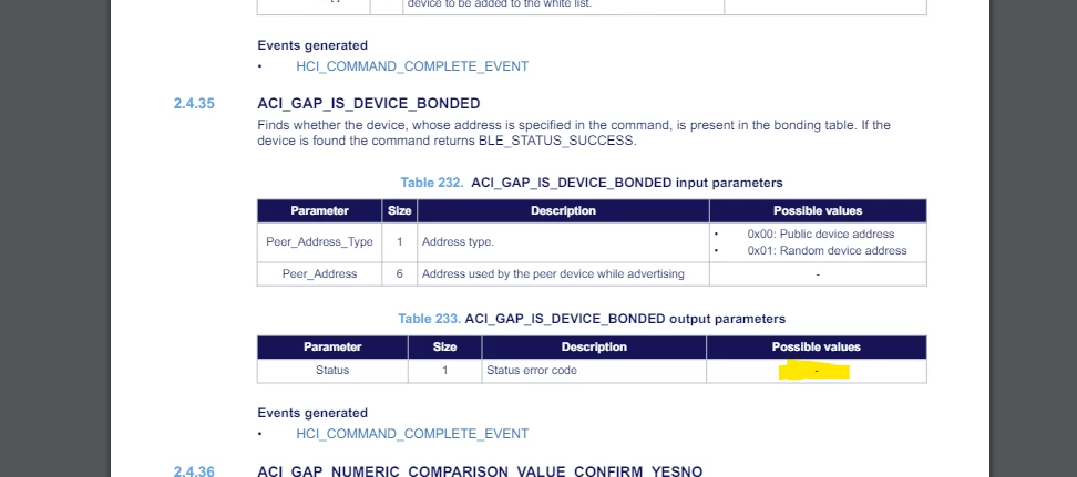

Possible values for ACI_GAP_IS_DEVICE_BONDED response packet
Found below what I assume to be the Possible Values for 'Status' , but not sure, any other?
0x5C Device not found in DB
0x5E Device not bonded
Can you list all of them?
Or are those values in the Bluetooth Specification? If so can you provide a link?

Hello @DS.4
The status parameters can take all Values on the Status error codes description (Table 463 of the AN5270).

This is very annoying to hear! There are like 100 of them..
To the question  is_device_bonded? You would expect  one simple answer..
Which ones are Bonding related? I would like to at least have a switch case to the ones related to the question.

According to the BLE Specifications, All the Values of the table are available in this Case.
