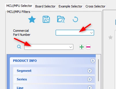

PS: By the way since I see you are a ST employee, there is a bug in the user interface 1.18.1. When at the project creation, you want to enter the commercial part number, after each character entered, the mouse pointers moves to the entry field with the + and - on the right side, so that after each character you have manually to move the pointer back to the commercial part number entry field which is not really user friendly.

Hello @Serge1
for this behavior, this is a known issue if you update the STM32CubeIDE to the newest version directly from the updater on a previous version. To avoid this you have to uninstall the Current version completely from your PC and re-install the newest one from the ST website directly. More details on the case number 207337 of the STM32CubIDE errata wiki.
Best Regards.
