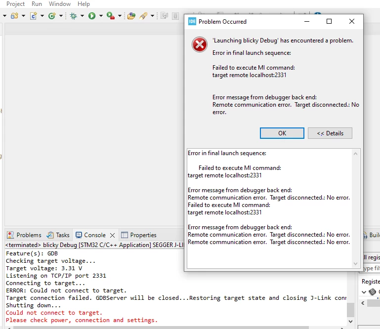

Please help us in resolving the error during Flashing the code i.e. (Error in Final launch sequence). Details are mentioned below.
I am trying to flash basic Led blinking code. During the flashing, I have seen the error which is attached with this forum. I have double checked the connections.
Details of the board: LoRa-E5 Dev Board which has STM32WLE5JC.
Debugger: Segger Jlink
IDE: STM32CUBEIDE
0693W00000aHhM8QAK.png Please do the needful.
Thanks
Mahesh

AScha.3
Feb 27, 2023 8:01 AM UTC
but debug telling. there is no connection.
what did you connect - details ?

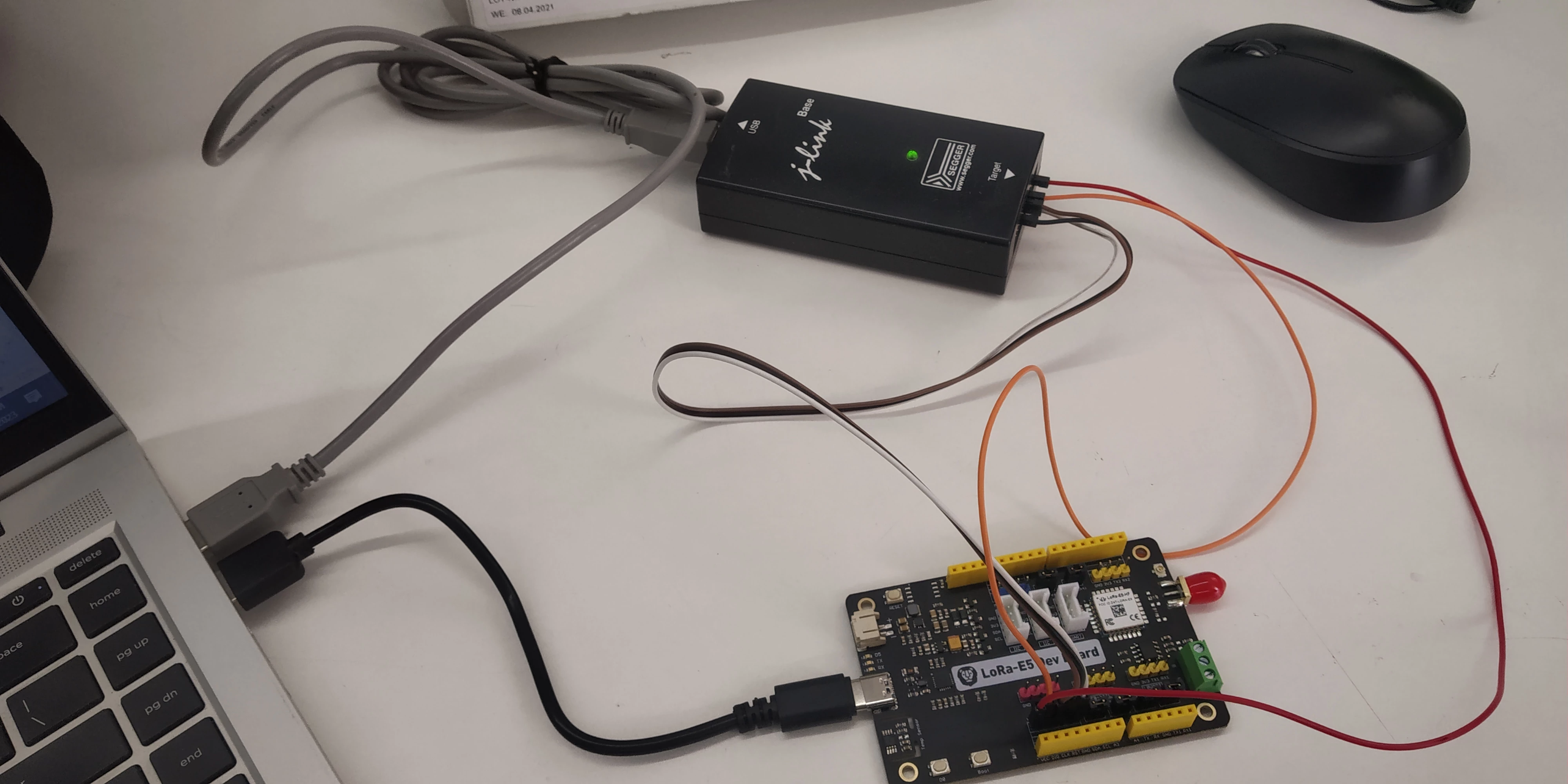

TGUDL.1
TGUDL.1Author
Feb 27, 2023 11:48 AM UTC
I have connected one end of the debugger (j-link) to PC and other end to the STM32WLE5 Development board (LoRa-E5 Dev Board). The connection looks as below. I am using J-link debugger to flash the code.0693W00000aHiY5QAK.jpg

AScha.3
Feb 27, 2023 1:00 PM UTC
connected are : gnd, vcc, swd, swc, rst ?
and then setting is: con.under rest ot try software sys.res.
TGUDL.1
TGUDL.1Author
Feb 28, 2023 4:07 AM UTC
Yes, the connections are connected as gnd, vcc, swd, swd, rst from the debugger to the Dev board. Will try the software system reset and update you. Thanks

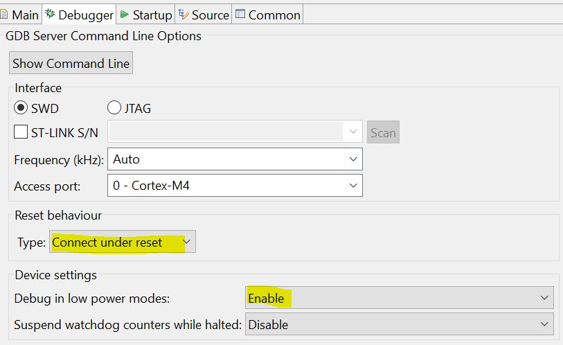

Wijeden RHIMI
Feb 28, 2023 10:35 AM UTC
Hello @TGUDL.1 ,
1- Try to test the same scenario with Cubeprogrammer
2- I wonder you to enable low power debug mode and connect under reset as shown in the screenshot bellow:
0693W00000aHpsbQAC.png Also, you should mass erase the flash memory using the following link that may help you to do that:
How to solve debugger connection issues (st.com)
Best regards,
Wijeden,
TGUDL.1
TGUDL.1AuthorBest answer
Mar 1, 2023 7:32 AM UTC
Thanks a lot for the support. Am able to flash the code in the Dev Board. The issue here is during configuration for ADC, one of the pins used for JTAG is misconfigured for the ADC and it causes the JTAG not able to connect the board.
Thank you,
Mahesh
