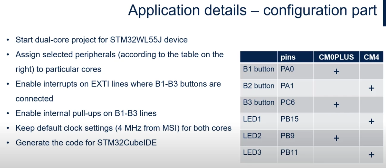

I am trying to assign specific GPIO pins (for a BUTTONs and an LEDs) to a specific core. However, when I right-click a pin in the Pinout & Configuration view, the "Pin Reservation" option is missing from the context menu.

I understand that this feature has not been implemented. Could you suggest another solution, then? In this course (Youtube), proposes the configuration below.
This is my first study to work with the cores, and I’m just getting started, so it’s really a basic approach. I truly appreciate your support.

STTwo-32Best answer
Jun 10, 2025 10:22 AM UTC
Hello @maborbaa
For now the only way to do that it is to generate the project without GPIO configuration throw CubeMX. After that in each main.c file or gpio.c if available, you need to create a MX_GPIO_Init() function where you have to initialize each pin to it function.
PS: This issue has been fixed on the STM32CubeMX V6.15.0.
