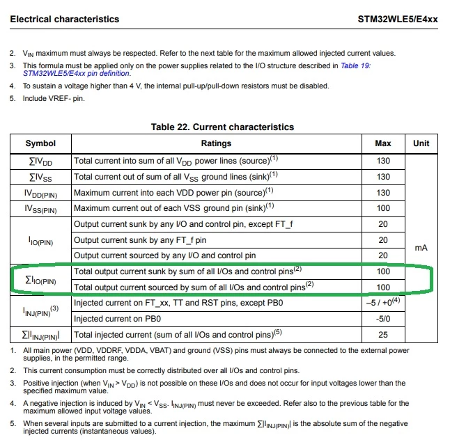

Part Number: STM32WLE55CC The GPIO sink current mentioned in the data-sheet is ±8mA; The ±8mA is a total GPIO sink or source current (or) individual GPIO current? Kindly elaborate in detail.

±20mA per pin with ±100mA max over all pins. Additionally (per data sheet):
The GPIOs can sink or source up to ±8 mA, and sink or source up to ± 20 mA (with a relaxed VOL/VOH).

Does that mean the current sink by any I/O pin is 20mA?

Less than 5 of them would seem to be the inference
