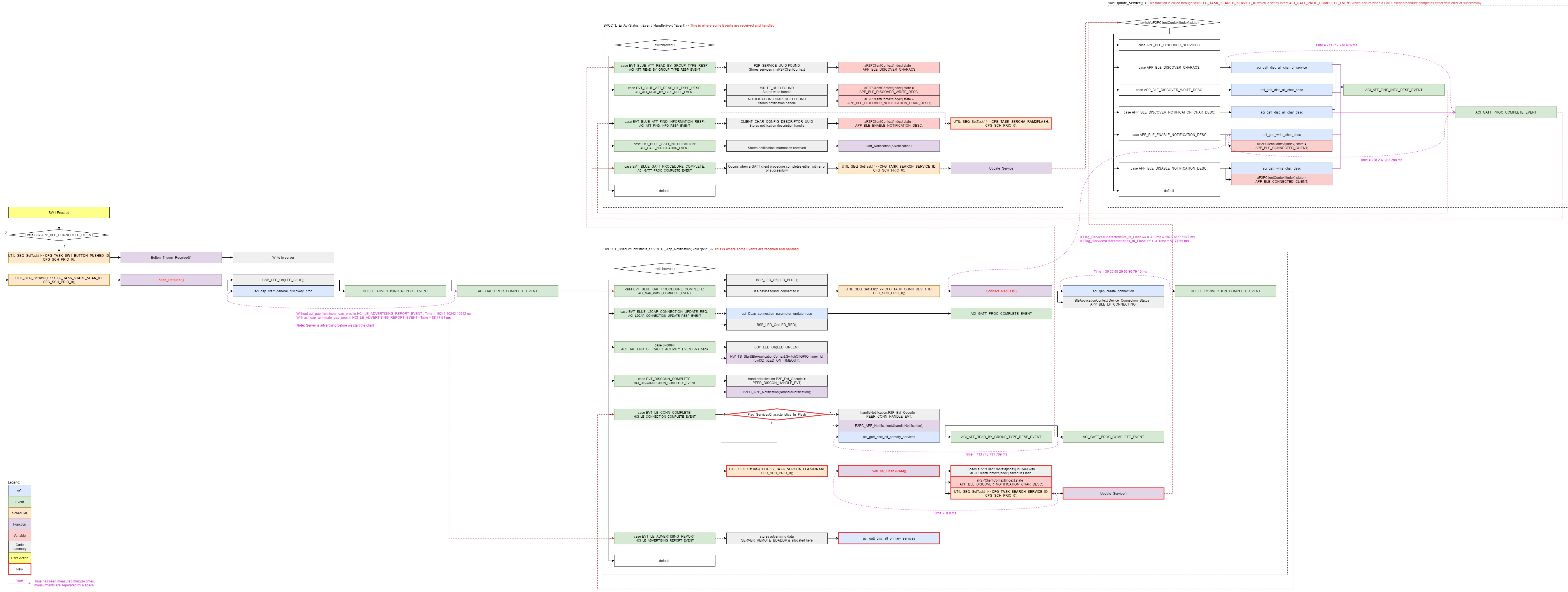

P2P server and P2P Client pair on STM32WB does not work when both are a stm32wb board but works when central is mobile. What should I do?
5 replies
sçıtı.1
Nov 19, 2022 9:35 AM UTC
I want to add details:
As I said in the question, they work well when the central is mobile and the peripheral is stm32wb board. However, when central is another stm32wb board they do not communicate.
When I try the p2p_server & p2p_client examples on different boards I could run and even modify the code without problem, they communicated well.
What might be the problem? In which file, should I make configurations, app_ble.c, custom_app.c ... etc.?
I think problem is here:
case ACI_GAP_PROC_COMPLETE_VSEVT_CODE:
 aci_gap_proc_complete_event_rp0 *gap_evt_proc_complete = (void*) blecore_evt->data;
 /* CHECK GAP GENERAL DISCOVERY PROCEDURE COMPLETED & SUCCEED */
 if (gap_evt_proc_complete->Procedure_Code == GAP_GENERAL_DISCOVERY_PROC
 && gap_evt_proc_complete->Status == 0x00)
 	 HAL_GPIO_WritePin(GPIOB, GPIO_PIN_5, RESET);
 APP_DBG_MSG("-- GAP GENERAL DISCOVERY PROCEDURE_COMPLETED\n\r");
 /*if a device found, connect to it, device 1 being chosen first if both found*/
 if (BleApplicationContext.DeviceServerFound == 0x01 && BleApplicationContext.Device_Connection_Status != APP_BLE_CONNECTED_CLIENT)
 APP_DBG_MSG("-- Device Found\n\r");
 UTIL_SEQ_SetTask(1 << CFG_TASK_CONN_DEV_1_ID, CFG_SCH_PRIO_0);
 else {
 APP_DBG_MSG("-- Device not Found\n\r");
 } break;
 This is the Debug LOG:0693W00000WIsoJQAT.pngFinally, I want to add a block diagram of the example, you can refer to the blocks for convenience.
