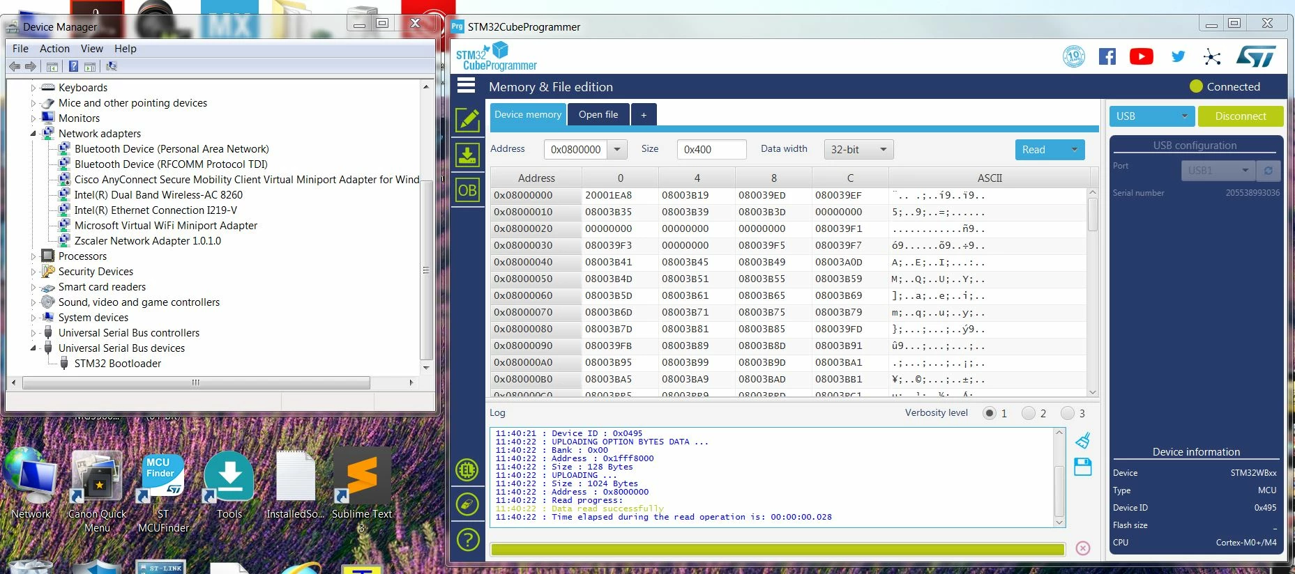

Remi QUINTIN
October 30, 2019
​You can also check if the USB device is OK by opening the device manager.  The USB device should be recognized a Boot Loader. See picture.

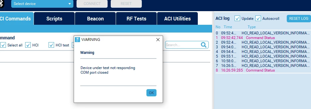

I connect JP5 DEBUG pins of Nucleo Board to CN1 DEBUG pins of USB Dongle, then use STM32cubePorg tools to Update Firmware.
When I use the example firmware: ble_transparent_mode_vcp, and connect USB Dongle on STM32CubeMoniter-RF.
It show a waring message : "Device Under the test no responing COM port closed"

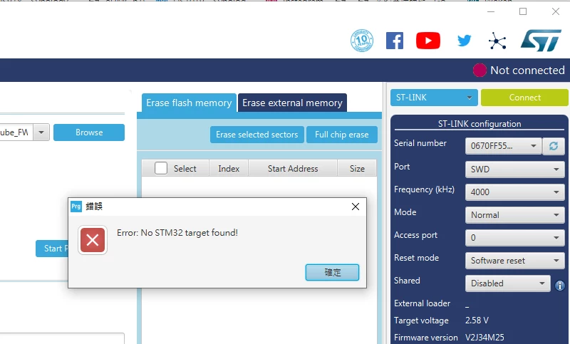

When I update back to demo example: BLE_p2pClient.
Then STM32cubePorg show a error message :"NO STM32 target found"
May I ask how to fix those problem?

Remi QUINTIN
November 6, 2019
​Indeed but when the USB DFU mode is used this nSWboot option byte is set to 1 with the command. Moreover the start of the issue was the USB device not detected.
Anyow it is worth the trial.
If you are able to connect with the JTAG/SWD port then you can either set nSWBOOT0 to 1 as the switch setting the PH3/BOOT0 pin is properly positionned.
launching the command STM32_Programmer_CLI.exe -c port=swd mode=UR -ob nSWboot0=1
or you can launch the command  STM32_Programmer_CLI.exe -c port=swd mode=UR -ob nSWboot0=0 nboot1=1 nboot0=1 regardless of  the PH3 BOOT0 pin.
or directly launch the complete command
STM32_Programmer_CLI.exe -c port=swd mode=UR -ob nSWboot0=0 nboot1=1 nboot0=1 -fwupgrade %FW% %ADDRESS%
