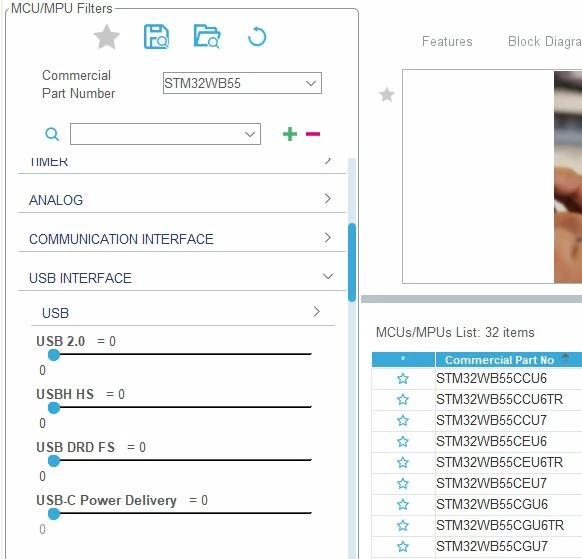

To use X-NUCLEO-DRP1M1 with TCPP03-M20 in order to perform a Dual Role Port application, the STM32 must embed UCPD controller.
Unfortunately, STM32WB55 series do not embed this controller. I've performed the check using Cube-MX.

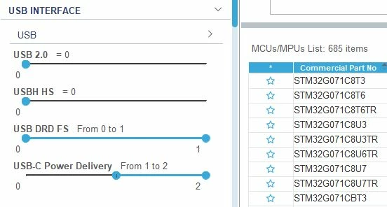

Fortunatly, 685 others STM32 embeds UCPD. I hope, you will find the one that corresponds to your needs.
Or, if only type-C SINK or SOURCE limited to 5V - 3A, you can use TCPP01-M12 or TCPP02-M18 and use associated X-NUCLEO-SNK1 or X-NUCLEO-SRC1. Then, resources must be attributed according to the examples on X-CUBE-TCPP.
