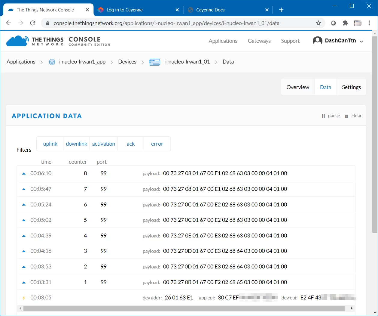

I could see traffic in the Gateway console view, and in the Device console view:
On the I-Nucleo-LRWAN1 device, the green LED blinks each time it transmits - I could see that a new payload appeared in the Device console view corresponding to each blink.

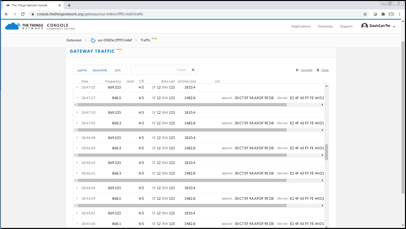

This did start the LED blinking again, but TTN Console views showed only Join requests - no actual data messages:
The Gateway did seem to be sending Join accepts, but the device never seemed to see them - it just carried on sending requests.

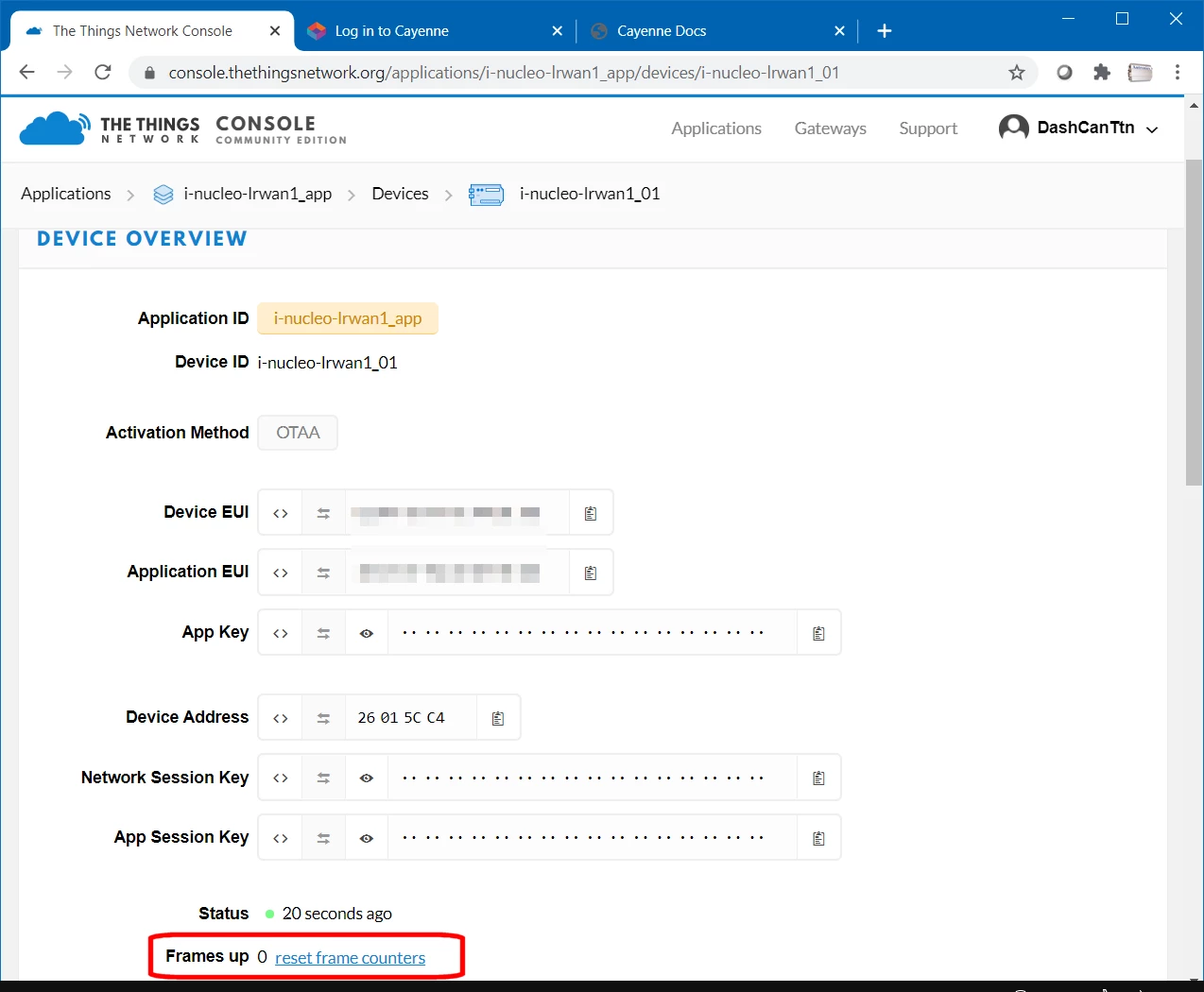

Another TTN forum post mentioned that the device message counters might be out-of-sync - so I did a ‘Reset Frame Counters’ on the Device Overview console page:
0693W000007CKzpQAG.pngThis made no difference.

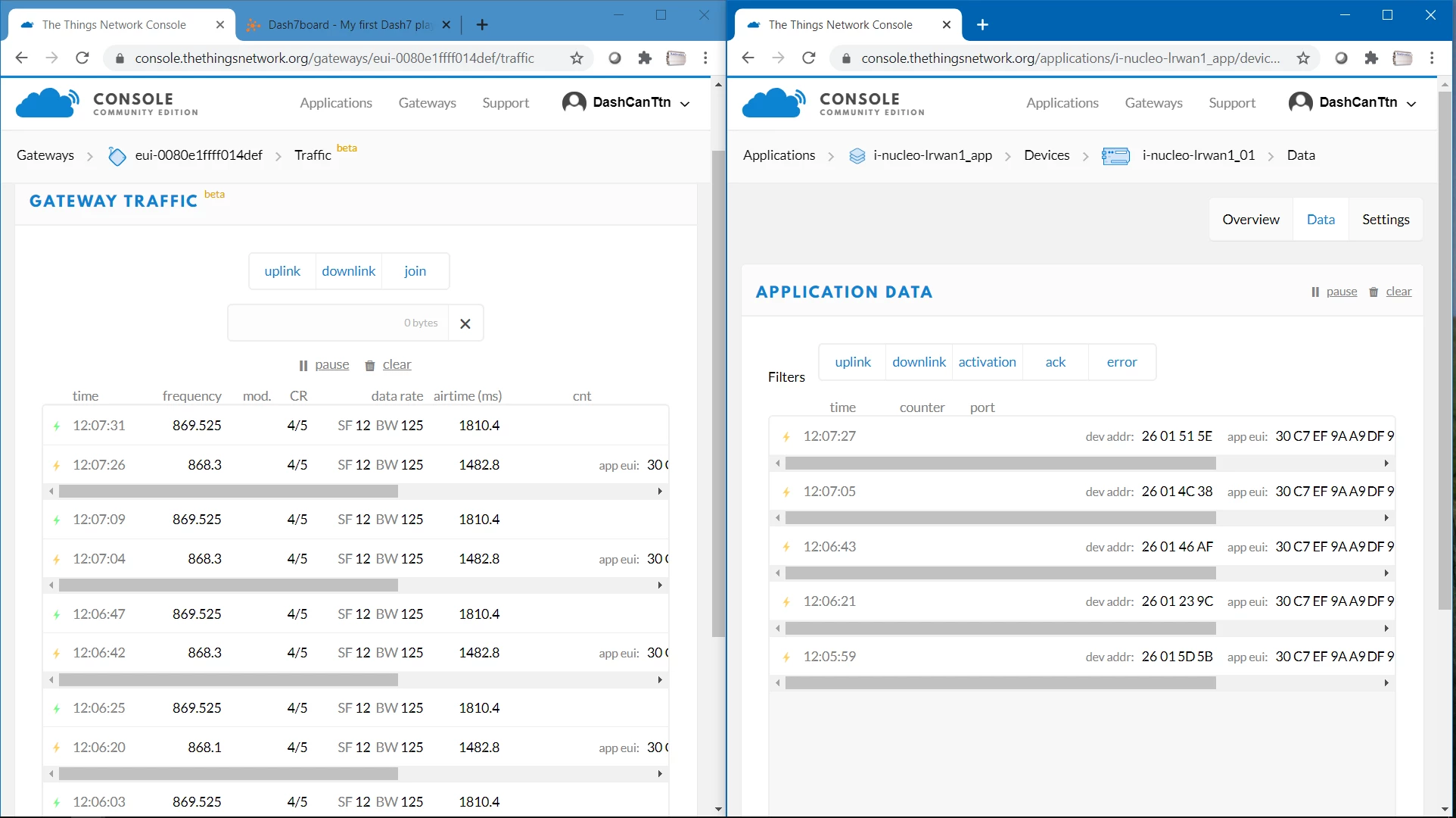

Mine was initially under 1 foot, but moving it to >12 feet away has made no difference:
The LD2 blue LED on the Gateway NUCLEO-F746ZG board blinks shortly after each blink of the I-Nucleo green LED (also after sending from the WizziLab device).
I haven’t seen a description of exactly what this indicates, but it seems to show that the Gateway at least thinks it has sent a reply?

While the I-Nucleo-LRWAN1 is in this state of not seeing Join Accepts:
0693W000007COOTQA4.pngThe Gateway is always sending its Join Accepts on 869.525, but the I-Nucleo sends its Requests on various frequencies. This is correct behaviour for the EU868 join RX2 window, which uses fixed settings
But TTN normally uses non-standard RX2 settings of SF9BW125 for non-join traffic - so could it be that the I-Nucleo is mistakenly also using SF9BW125 because it's on TTN, rather than reverting to standard for the TTN "special case" of joining?
https://www.thethingsnetwork.org/forum/t/st-p-nucleo-lrwan2-stopped-working/43127/10?u=dashcanttn
