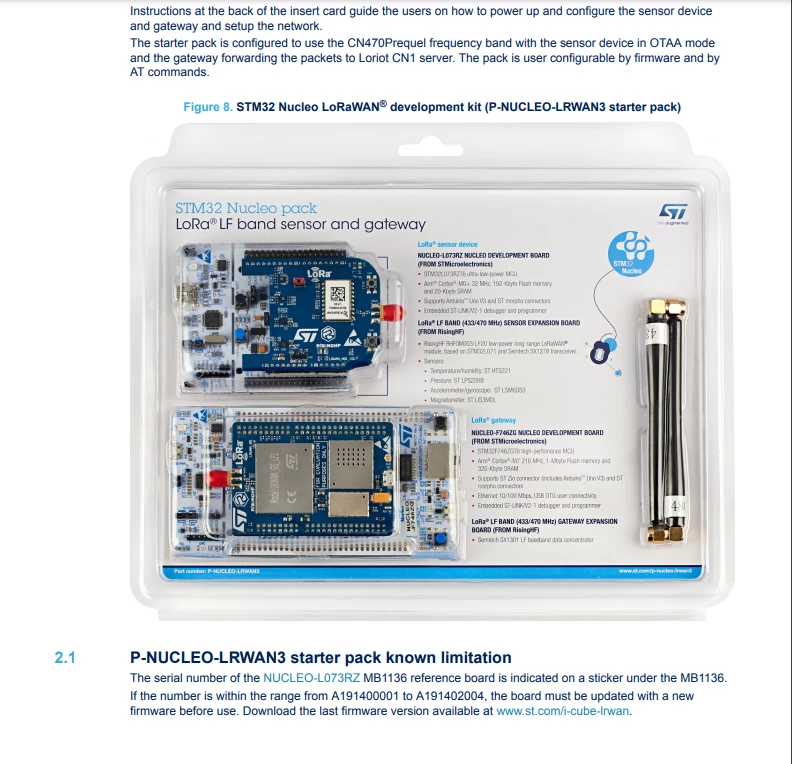

I got the package P-NUCLEO-LRWAN2
It consists of an endnode and a gateway for sending date from endnote to gateway and further to an application.
In the manual (UM2587) "Getting started with the P-NUCLEO-LRWAN2 and P-NUCLEO-LRWAN3 starter packs" on page 10 is that statemaent:
My endnode NUCLEO-L073RZ falls into that range, and therefor I have to change the sotfware. In the softwarepackage of i-cube-lrwan are parts related to different MCU and also to different 'cases' (AT_Master and End_Node).
I guess I have to select the part STM32-L073RZ, but what case (AT-Master or End-Note).
in the documentation i found no hit what is preloaded for the endnode.
An other question why can't be used for reprogramming the endnote the STM CUBE IDE?
Has anyboddy a answer?

It's a LRWAN_NS1 module, with a RisingHF chip. It's the P-NUCLEO-LRWAN3 pack - the warning mentioned by the OP applies to upgrade firmware applies specifically to that board. See the bottom of page 10 of this document:
https://my.st.com/content/ccc/resource/technical/document/user_manual/group1/01/0e/9a/df/16/73/42/51/DM00620948/files/DM00620948.pdf/jcr:content/translations/en.DM00620948.pdf
Regarding the AT command - yes, that's where the problem is. The AT commands to the LRWAN module are not working. I'm using the latest software downloaded from https://www.st.com/content/st_com/en/products/embedded-software/mcu-mpu-embedded-software/stm32-embedded-software/stm32cube-expansion-packages/i-cube-lrwan.html
I'm running the sample code at STM32CubeExpansion_LRWAN_V2.0.0\Projects\NUCLEO-L073RZ\Applications\LoRaWAN\LoRaWAN_AT_Master\STM32CubeIDE\LRWAN_NS1
The gateway firmware isn't an issue (at this stage anyway).
Mark

The manual I'm referring to is page 10 of this document:
Specifically, the warning at the bottom of page 10 which says:
P-NUCLEO-LRWAN3 starter pack known limitation The serial number of the NUCLEO-L073RZ MB1136 reference board is indicated on a sticker under the MB1136. If the number is within the range from A191400001 to A191402004, the board must be updated with a new firmware before use. Download the last firmware version available at www.st.com/i-cube-lrwan.
The project I'm trying to get running is indeed the AT-Master example that you mention.
The AT Commands that I'm referring to are AT commands being sent from the NUCLEO-LO73RZ board (in the AT-Master code) to the LRWAN-NS1 module. This is not via the STLink. I'm watching the sending and receiving via the debugger, and there seems to be no response to AT commands being sent. They're being sent from uart1 on the NUCLEO board to the LRWAN-NS1 module.
We have managed to send AT commands via a usb to uart bridge from the PC to the pins on the LSWAN-NS1 module.
Regarding v2.0.0 being broken - thanks. That probably explains things. Do you have a link to version 1.3.1 perhaps?
