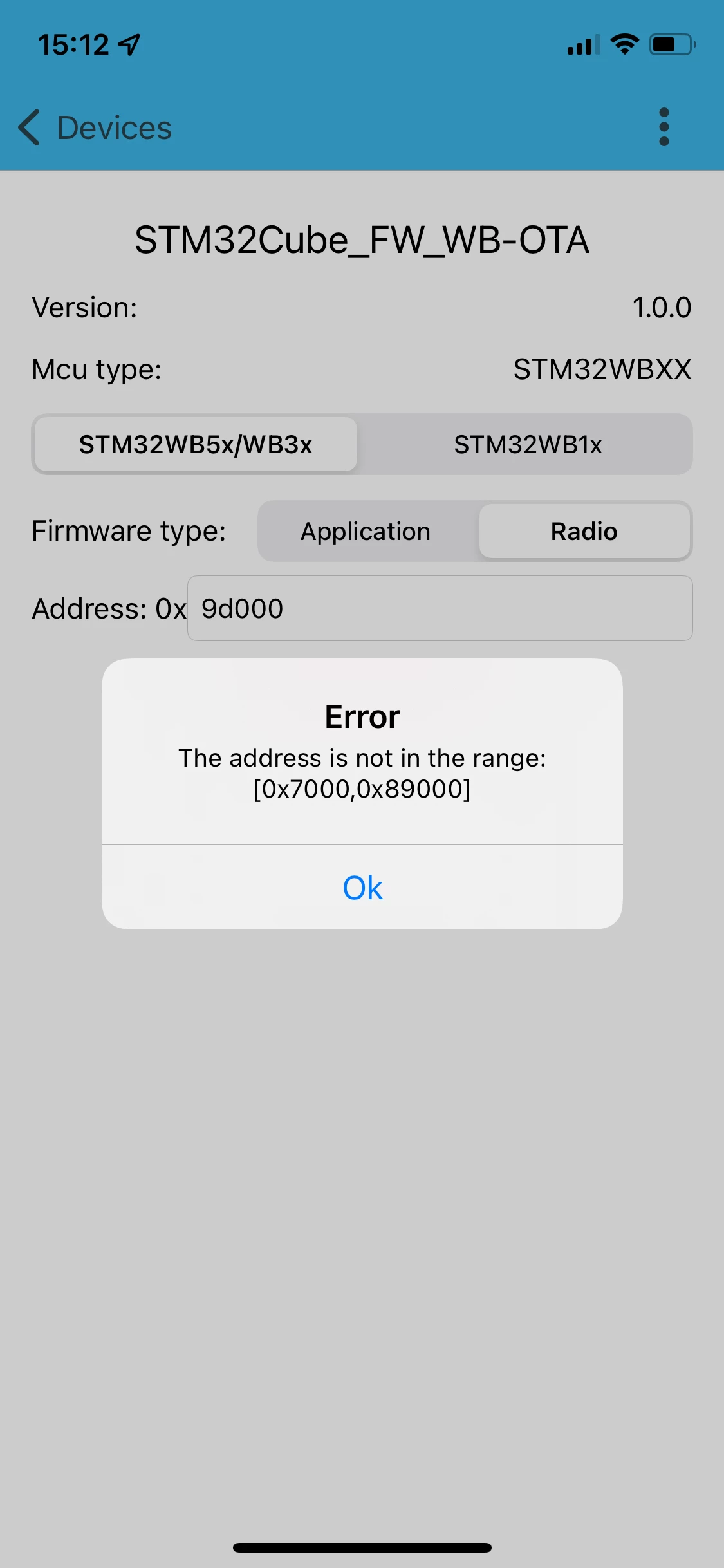

Good day,
As an extension of this discussion, I'm having trouble updating the BLE stack using the BLE_Ota code.
From the linked discussion, I should be downloading my new stack to 0x0809D000 (I'm also going from an older, smaller stack at 0x080CB000 to 1.13.X).
However, I'm having the following issue:
  1. The STM BLE Sensor app does not allow me to enter 0x0809D000 as a valid address (see image), so I can't test if the address is the issue. In the context of the app, it would be 0x9D000.
  2. Using another address (say 0x08060000 or 0x08080000) does not work - SHCI_C2_FUS_GetState return with error code FUS_STATE_ERROR_IMG_NOT_FOUND.
To my understanding the FUS should find the firmware automatically by looking for some magic word. If this were true, then there is no reason why it should not find the image at 0x08060000 or 0x08080000.
Any thoughts as to what is going wrong i.e. why is the image not found?

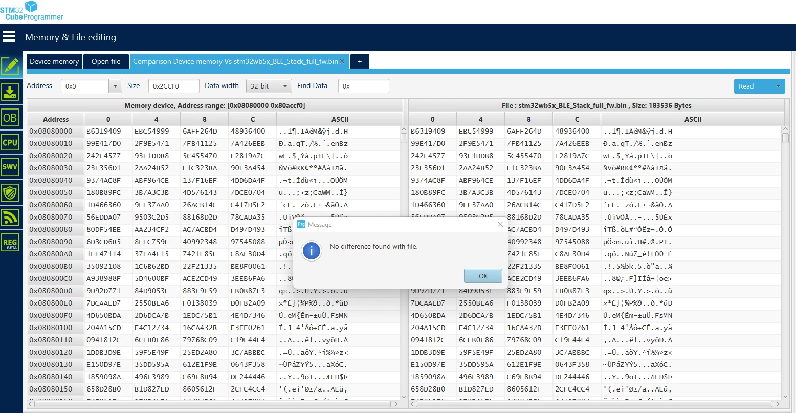

I've done more testing, but to no avail.
Here's what I've tested:
  • The data does get uploaded correctly - see the screenshot of a comparison between the memory on the device and the BLE stack binary
  • Using a custom app, I uploaded the binary to 0x0809D000, but I still got the same error response of FUS_STATE_ERROR_IMG_NOT_FOUND.

First, I see in your screenshot that you have a board with the FUS version v1.1.1.0, I recommend you to update the FUS with v.1.2.0, you can look this wiki page which describe how to update the FUS.
Once it's done, in order to update the BLE Stack using OTA, you should used an address between the end of application address and the secure part (see SFSA option byte) minus the image size. On ST BLE Sensor application, an offset is used (start from 0x08000000), so if you want to download your stack is 0x0800A000 for example, you should enter 0xA000 on the application. Image start address must be aligned to sector start address (this is a multiple of 4-kbytes). This address is the download address, not the install address.
