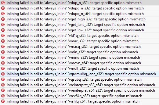

Graduate
Jan 23, 2024 6:00 AM UTC
Hi LR.2,
My error outputs are like this but I couldn't find a solution.
Thanks & Regards

LR.2
LR.2AuthorBest answer
Feb 8, 2024 5:54 AM UTC
I integrated opus in my project.
Things I did:
1. I opened example project which present inside the "X-CUBE-OPUS.zip" and explored what are the files included from the opus library. To check this I read ".cproject" and ".project" from the example file, then I added those files in my project.
2. After that I checked the compiler options from the project build settings and I made changes in my project compiler options with that.
3. Also, I checked build output for "fpu" based compiler options and set in my project. Opus needs "-mfpu=fpv4-sp-d16" "-mfloat-abi=hard" options to get compiled. (Before adding this option verify your controller has support for FPU).
After all the above changes in my code I got compiled successfully.
Thanks and regards,
Laksh
