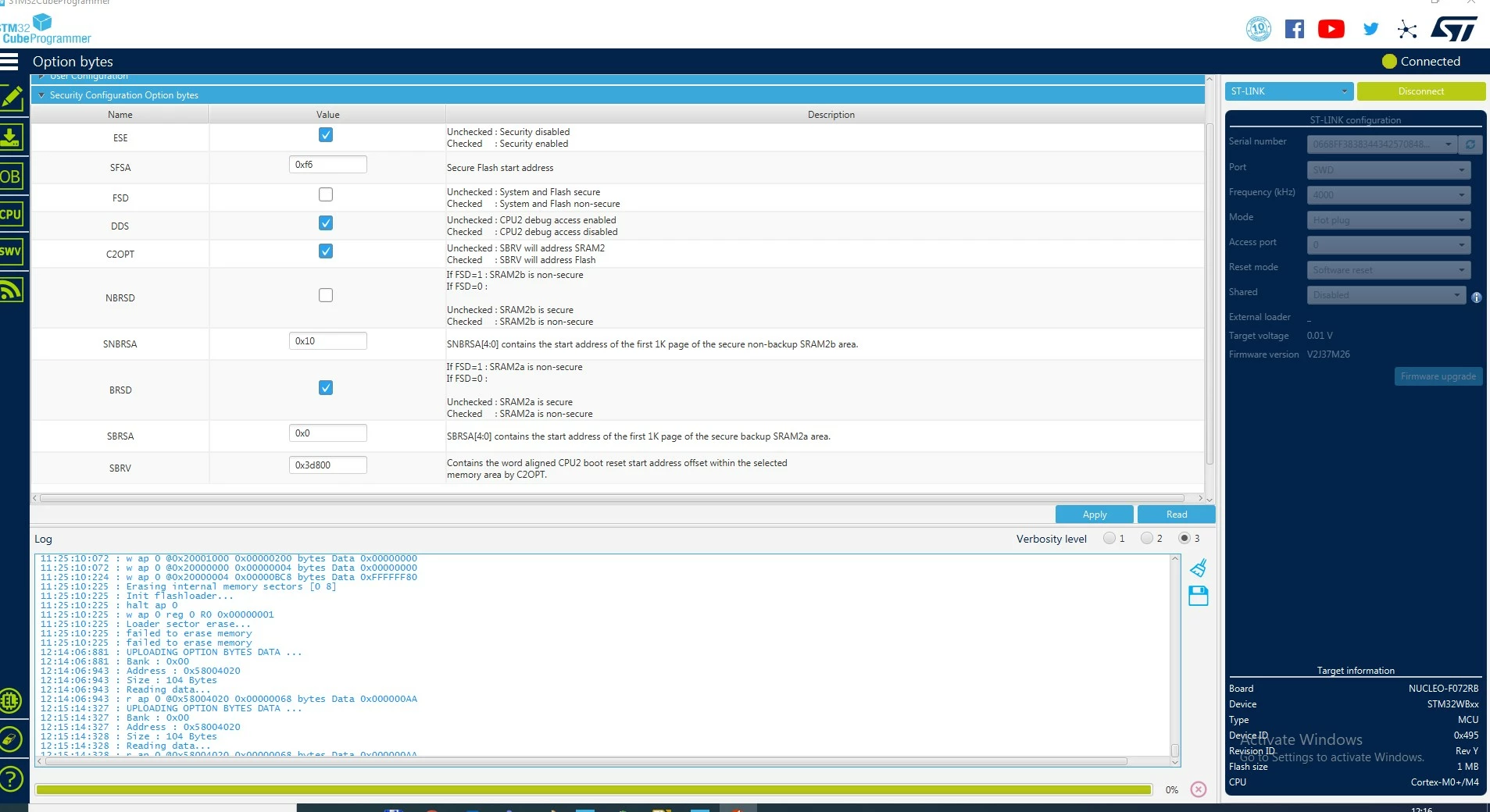

Good Day.
I have created a board and some program easily through SWD port and some struggle.
The error i am getting In STM32CubeProgrammer is:
08:35:51:413 : Reconnected !
08:35:51:413 : Success with Time elapsed during Reconnect: 4314 ms
08:35:51:413 : UPLOADING OPTION BYTES DATA ...
08:35:51:414 : Bank : 0x00
08:35:51:414 : Address : 0x58004020
08:35:51:414 : Size : 104 Bytes
08:35:51:414 : Reading data...
08:35:51:414 : r ap 0 @0x58004020 0x00000068 bytes Data 0x000000AA
08:35:51:414 : OPTION BYTE PROGRAMMING VERIFICATION:
08:35:51:414 : Expected value for Option Byte "nSWboot0": 0x0, found: 0x1
08:35:51:414 : Option Byte Programming failed
08:35:51:415 : Failed to set nSWboot0=0 nboot1=1 nboot0=1
I am trying to load
stm32wb5x_FUS_fw_1_0_2.bin
to start address 0x080EC000
on new stm32wb55RG
Even when trying to download a Hex file to program space 0x8000000

​For the option bytes, send a screen shot of the CubeProgrammer tool once in the OB section.
> have only SWDIO / SWDclk and GND connected from a nucleo board. => I your board a Nucleo board or yur own custom board? I dont understand this sentence.
Mass erase fails because it encounters the memory blocks protected by the SFSA limit. But all blocks under SFSA location should be correclty erased.
HSpre.1
HSpre.1Author
Oct 7, 2020 10:19 AM UTC
Hi I am using my own board. I have produced 18 boards.
I am connected to this board using a nucleo as programmer (nucleo-f072RB). I am only connecting SWDIO / SWDclk and GND from the nucleo board to my stm32wb55 board. the STM32WB55 board is powered with a battery.
see below scren grab , not certain which part you want to see of option bytes?
HSpre.1
HSpre.1Author
Oct 7, 2020 10:25 AM UTC
I just dropped my Frequency to 100khz ( from standard 4000) and then my programming worked. I am a bit stumped as to why communication can be this bad?
Remi QUINTIN
Oct 7, 2020 10:32 AM UTC
Few remarks
SFSA = 0xF6 means that the FUS version is still v0.5.3. So you should try to upgrade the FUS version to V1.0.2 and then to v1.1.0.
Regarding the frequency, a lower programming speed could increase the reliability of the write accesses. But I must admit that the 4000Khz frequency I am using to program the WB Nucleo board is working well with the USB interface; with the SWD too though with more error. I don’t know if there is a link with the programming frequency.
