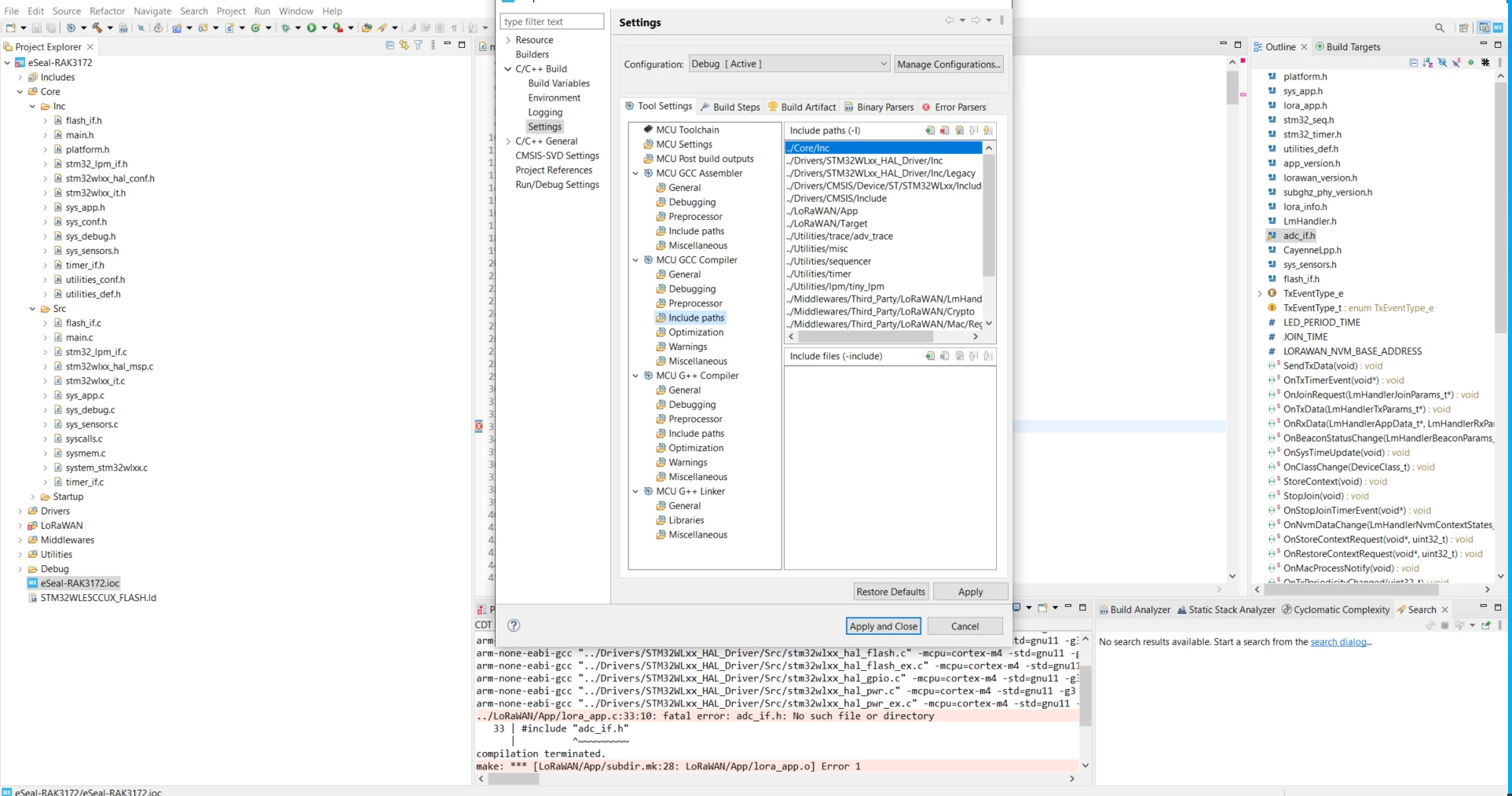

rib.1
rib.1Author
Mar 13, 2023 8:29 AM UTC
hi Wijeden,
first of all thanks for your reply.
as you see i think that the path is already included ...
