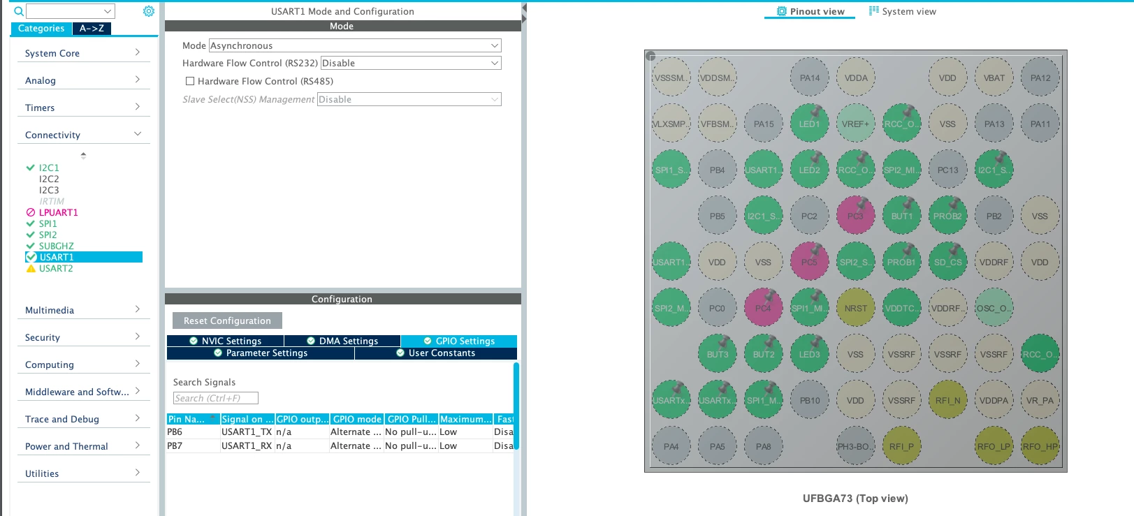

IOC file for nucleo, I am using usart1 for communication between boards, and usart2 for coms to PC for debugging.

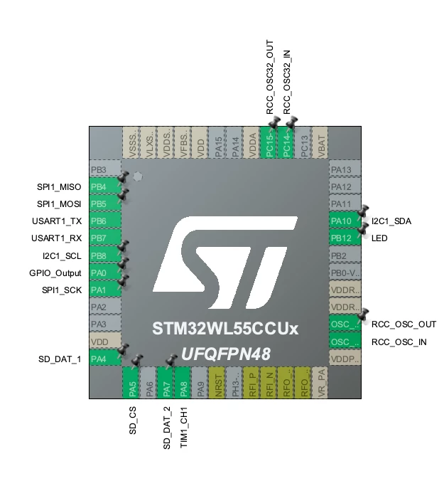

IOC file for custom hardware. Note that the uart pins were initially for the STLINK, however, due to some design changes, they are being used to communicate between boards.
