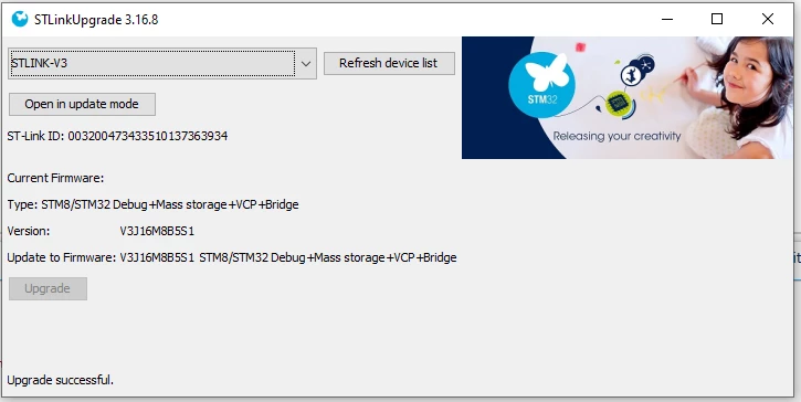

So, check the correct MCU connection to ST-Link and ensure that the ST-LINK firmware is up to date.

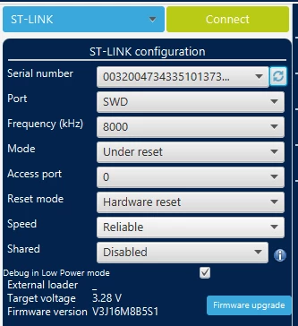

With CubeProgrammer, try connecting "under reset" and erase the firmware.

Hello, thank you for the reply.
In CubeProgrammer, it lets me update the firmware but when trying to connect under reset (at the same time pressing the reset button) the error "Unable to get core ID. No STM32 target found." appears.
