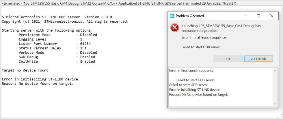

I bought a nucleo-wl55 card from RS.
At the beginning, it worked very well and i started to develop my application.
Suddenly today, when i try to run my program, i get an error message : st-link cannot detect a target.
And the card become very hot !
Any suggestion !

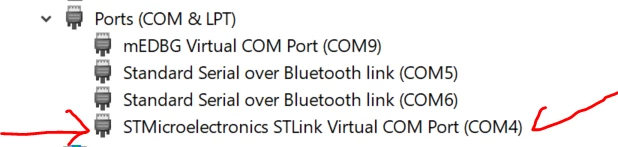

when i connect the card i can detect the virtual com port :

Hello @malarab​ ,
I advise you to try with :
  • latest release of STM32Cubeprogrammer.
  • connect "Under reset mode".
  • BOOT0 pin pulled HIGH

The connectivity of the STM32 Target, and the presence of the ST-LINK in Windows are two different things.
The STM32 Target can be difficult to access if it powers off the JTAG/SWD or the core itself. You should watch what your code does with the pins and low power modes.
Would strongly recommend a long spin loop in the Reset_Handler to allow for connectivity to be established.
BOOT0 being HIGH allows code in ROM to run, rather than user code.

hello @Imen DAHMEN​ and @Community member​,
Thank you for your answers,
I have upgraded to the last version 1.10, connected under reset and pulled high boot0 pin ... but always the same problem.
effectively, i know that st-link is different from target, but is to verify that at least the programmer is working well.
as i said before, the card start heating ! the heat source become different according to the power source :
  • if 5V_sel = stlink : U5 (5V regulator from usb) start heating
  • if 5V_sel = 5V_VIN or E5V or CHG (to bypass U5) the mcu (wl55) start heating
I have also tried to connect with an external j-link (to verify if the problem came from st-link) but always the same problem (no target detected)
Finally i have verified all previous connection and my application software on a new nucleo card, and it is work correctly.
So i think they have a hardware issues in my previous card, and i am interested to know what can be the source of this problem, and if it will be possible to resolve it (maybe by replacing a component)
