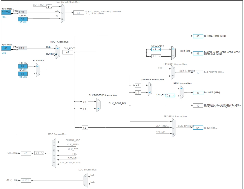

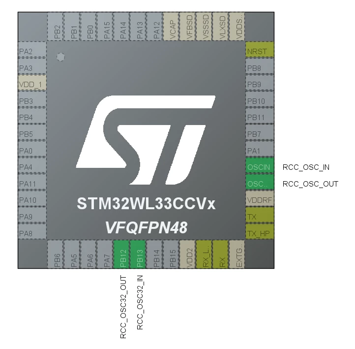

The problem we are facing is very strange: we can't connect to the board after some operation.
we have created a new project with Cube MX 6.13 for STM32WL33CCVx, and then we configured only the clock tree.
The idea was to try different stop modes and measure the current consumpion using NUCLEO JP2 jumper.
We did these steps:
- created a new project in CubeMx selecting STM32WL33CCVx target
- enabled HSE oscillator and configured the clock tree in this way:
- thus we obtained this simple configuration:
- generated the code from the .ioc file
