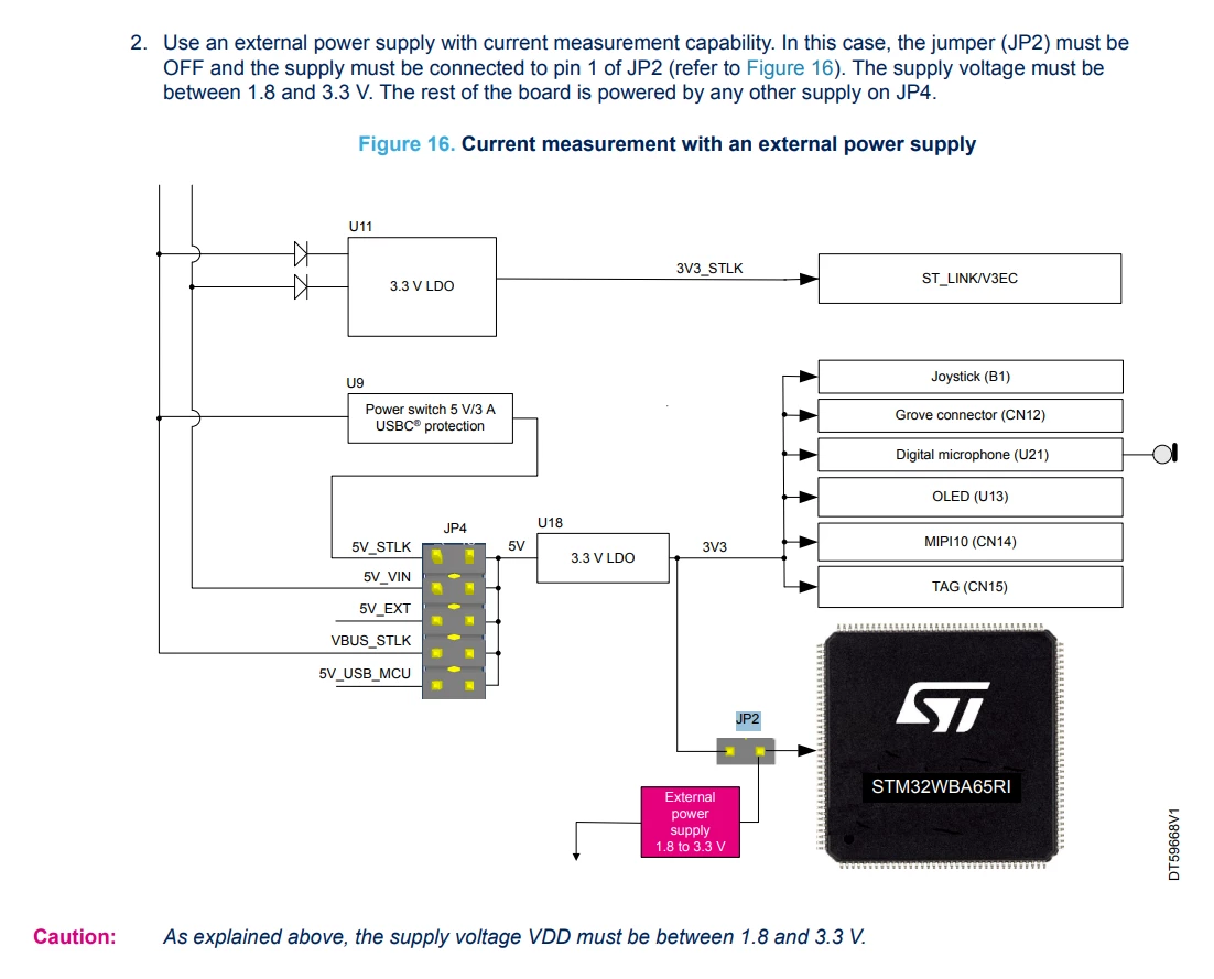

I am using the STM32WBA65RI Dev Kit. For current measurements, I am powering the board with an external supply that includes current measurement capability, connected directly to pin 1 of JP2. The JP4 jumper is removed.

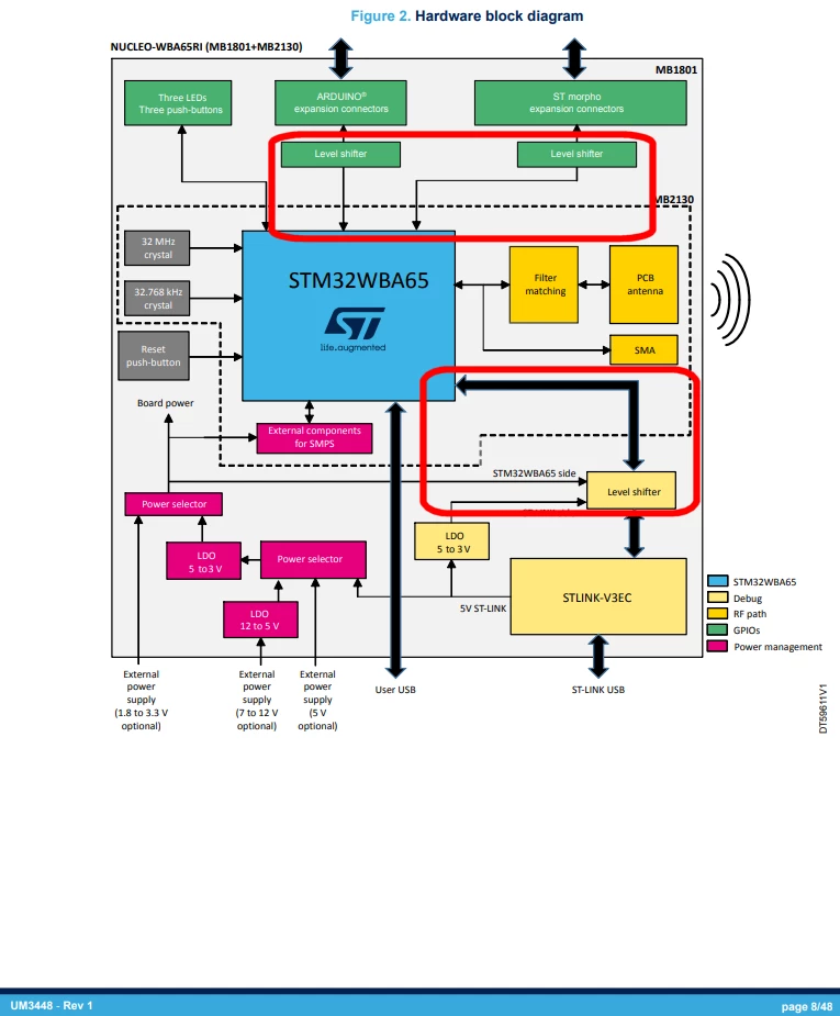

You need to carefully check the schematics for all potential sources of leakage - in particular, connections to the ST-Link.
Your difference is on the order of only 400nA - it really doesn't take much leakage at all to make that !

I am using the NUCLEO-WBA65RI. According this this image, I am powering the MCU directly so the ST-Link below should be totally disconnected (I assume)

What about all these connections (from the User Manual):
https://www.st.com/resource/en/user_manual/um3448-stm32wba-nucleo64-board-mb1801-and-mb2130-stmicroelectronics.pdf#page=8
Again, it's only tiny amounts of current you're talking about!
Maybe try removing the MCU RF board (MB2130) from the mezzanine board (MB1801) ?

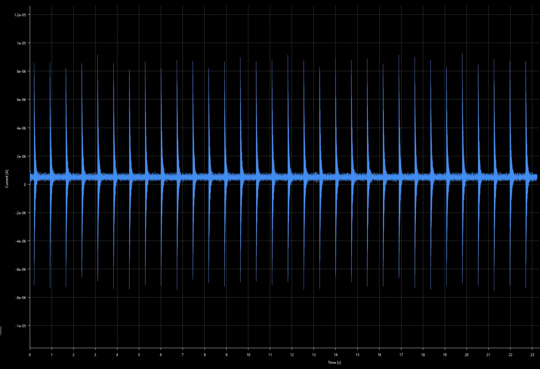

Hello, I have removed the MCU board (MB2130), and I am powering up via CN4 pins. I have shunted the necessary solder bridges underneath the board I got these results while in stanby mode.
image (1).pngI can´t figure out what are those negatives spikes. The average value should be around the nano amps scale, but again not the 330nA at 1.8V specified in the datasheet.

I have already tried that.. in that case I connect Vdd into PIN1 of CN4 and GND into PIN3 of CN4.
